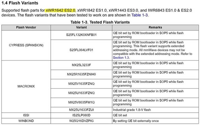

We would like to use WINBOND “W25Q32JVSSSQ” flash as 2rd source, but it is not in the supported flash parts for AWR1642 ES2.0.
Since we have tried to mount the WINBOND “W25Q32JVSSSQ” flash in our board, but it cannot work.
1. Does AWR1642 ES2.0 support it?
2. If YES, any settings should be modified?
3. If NO, will it support in future?
Below supported flash parts capture from "IWR6x43 Flash Variants Supported by the mmWave Sensor (Rev. C)".
