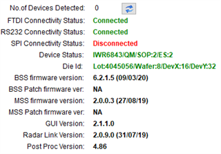

I am using an ES2.0 IWR6843ISK and mmwave_studio 2.1.1.0 and connect directly without mmwave carrier board to the DCA1000EVM. Going through the steps of connecting UART and loading BSS and MSS firmware works.
But there is a problem connecting the SPI.
Here is the Output log:

[15:25:49] [RadarAPI]: ar1.PowerOn(0, 1000, 0, 0)
[15:25:49] Status: Failed, Error Type: RADAR INTERFACE ERROR
[15:25:53] MSS Power Up async event was not received!
SW2[1:8] = 00001000 (DCA1000)
SW1[1:3] = 110 (DCA1000)
SW[1:6] = 011000 (ISK board)
Am I missing something?

  • Hello Gunter,
    The error highlighted in your log points to some connection issue. Would be good if you could share pictures of your board connections.
    Are all your hardware connections and wires proper? Have you used the correct COM port number for RS232 connection?
