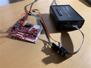

I bought an XDS110 Debug Probe (Datasheet here https://www.ti.com/lit/ug/sprui94/sprui94.pdf?ts=1651406157309&ref_url=https%253A%252F%252Fwww.ti.com%252Ftool%252FTMDSEMU110-U) and I am trying to connect it to my AWR6843ISK.
My connections are as follows.
AWR6843ISK J1 60 Pin HD Connector XDS110 Debug Probe Debug
Pin13 TADAR_TMS Pin1 SWDIO/TMS
Pin12 RADAR_NRST_1 Pin2 NTRST
Pin11 RADAR_TDI Pin3 TDI
Pin4 VCC_3V3 Pin5 VTREF
Pin17 RADAR_TDO_SOP0 Pin7 SWO/TDO
Pin20 GND Pin8 GND
Pin15 RADAR_TCK Pin11 TCK
I loaded the Debug Software onto the Radar Module. I power the Debug Probe with its USB and the Radar as well over the Micro USB. When I am testing my target configuration in Code Composer I get the following output

  • Hello Christoph,
    Could you send me a picture of the setup?
    -Shareef
  • Hi Shareef,
    this is how it looks
    I checked the connection of of both sides with a voltmeter. So I believe the table above should show the correct connections.
    Christoph

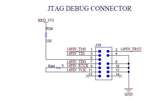

  • Christoph,
    Below is the JTAG connection using MMWAVEICBOOST board from the XDS110 Debug Probe.
    NRST should be not be connected to pin 2 of the XDS110 connector, NRESET activation using JTAG is not supported hence it should be disconnected.
    TCK and RTCK need to be looped back, all the ground pins need to be connected.
    In the below diagram 14pin TRST is not connected to mmWave sensor.
    Also TDO serves as boot mode for the device (It is also one of the SOP pins), During the power up JTAG debugger should not be connected as it affects the boot mode of operation.
    After booting in functional mode JTAG can be connected.
