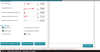

Im using the mmwave wave demo visualiser to visualize the flashed code.
But the problem in visualiser its showing the hardware is connecting /sometime it will waiting for data
please help me in this

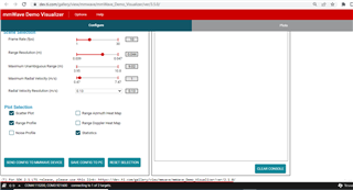

  • Hi..Cesar,
    when we bought this module,with in 1 minute we are able to connect to hardware but from 2days i was facing this issue in connecting to hardware. if i kept for 1 hour also its showing it was connecting,the snapshot is shared below
    without solving this issue we cannot progress our work
    Akhil

  • Hi cesar,
     we are able to visualize after flashing  the .bin from SDK 3.5. But the problem is after flashing Out_of_ box_ demo_16xx(.bin_file)  which is builded in ccs studio its showing the data port com 3 is waiting for data. From long time i was trying  but unable to connect to  the visualiser.
              i restarted my PC and i have installed visualizer app ,later also we are getting same problem.please help me with this issues
    Akhil
    So, it seems that the issue is not the Visualizer but the bin file built with CCS.
    How was this file built? Did you create the CCS project? I think that the CCS project is not correct.
    You should use the make file included in the SDK to re-build the demo.
    Thank you
    Cesar
