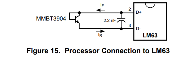

Hi Sir,
I would like to know if I am not using thermal sense function of LM63 and external transistor as below (MMBT3904) for sense any temperature. How do I design on pin D+ and D-?
BRs

Hi Chaochen,
Page 14 of the datasheet describes device behavior when the transistor is not present. I would recommend connecting a small MMBT3904 next to the LM63 to avoid any issues.
thanks,
ren
