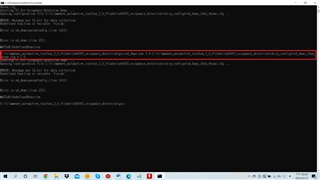

Hi team:
I want to redo the data collection of occupancy detection, but I modified odddemoParms to become 3 8 0.001 0.50 18, and there is an error when I restart the demo program

    From the profile config it looks like you are trying to use the demo with a different GUI. The parameters and the GUI may not match each other for different demo and this could be one of the possible reasons for the error. Have you tried to use the GUI from the same demo and check if it worked fine?
