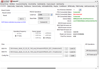

I am using AWR2243BOOST with DCA1000. Using mmWave studio 3.0.0.14. When I try to connect to the com port, the RS232 Connectivity status stays "Disconnected" as shown in attached image.  The output script are given as follows:

[18:08:35] [RadarAPI]: Opening Gpio Control Port()
[18:08:35] [RadarAPI]: Status: Passed
[18:08:35] [RadarAPI]: Opening Board Control Port()
[18:08:36] [RadarAPI]: ar1.FullReset()
[18:08:36] [RadarAPI]: Status: Passed
[18:08:37] [RadarAPI]: Closing Board Control Port()
[18:08:37] [RadarAPI]: Status: Passed
[18:08:37] [RadarAPI]: Closing Gpio Control Port()
[18:08:37] [RadarAPI]: ar1.SOPControl(2)
[18:08:39] [RadarAPI]: ar1.Connect(8,115200,1000)
[18:08:41] [RadarAPI]: Error: Connection failed: Calling_ConnectTarget returned 3
[18:08:41] [RadarAPI]: ar1.Calling_IsConnected()
[18:08:41] [RadarAPI]: ar1.SaveSettings('C:\Users\Awais\AppData\Roaming\RSTD\ar1gui.ini')
[18:08:47] [RadarAPI]: ar1.frequencyBandSelection("77G")
[18:08:48] [RadarAPI]: ar1.SelectChipVersion("AR1243")
[18:08:48] [RadarAPI]: Status: Passed
[18:08:48] [RadarAPI]: ar1.deviceVariantSelection("XWR2243")
[18:08:50] [RadarAPI]: ar1.DownloadBSSFw("C:\\ti\\mmwave_studio_03_00_00_14\\rf_eval_firmware\\AWR2243_ES1_0\\radarss\\xwr22xx_radarss.bin")
[18:08:50] [RadarAPI]: Error: Download FW failed with error -1
[18:08:52] [RadarAPI]: ar1.DownloadMSSFw("C:\\ti\\mmwave_studio_03_00_00_14\\rf_eval_firmware\\AWR2243_ES1_1\\masterss\\xwr22xx_masterss.bin")
[18:08:52] [RadarAPI]: Error: Download FW failed with error -1
[18:08:54] MSS CPU Fault error status Async event recieved(0x3, 0x0,0xFFFFE580, 0x0,0x0, 0x0,0x0, 0xFFFF,0xFF, 0xFF,0xFF, 0xFF)
[18:08:54] MSS power up done async event received!
[18:08:54] [RadarAPI]: ar1.PowerOn(0, 1000, 0, 0)
[18:08:54] [RadarAPI]: Status: Passed
[18:08:56] [RadarAPI]: ar1.SelectChipVersion("AR1243")
[18:08:56] [RadarAPI]: Status: Passed
[18:08:56] [RadarAPI]: ar1.SelectChipVersion("XWR2243")
[18:08:56] Device Status : XWR2243/ASIL-B/SOP:Inv/ES:1.0
[18:08:56] [RadarAPI]: ar1.RfEnable()
[18:09:12] Status: Failed, Error Type: RESP TIMEOUT
[18:09:17] BSS Power Up async event was not received!
Is there anything I am doing wrong?
