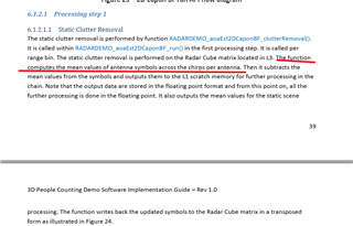

What do the antenna symbols in the screenshot refer to? Please help explain in detail.
Hi Nancy,
This static clutter estimation is the mean across the chirps per virtual antenna and range bin.
Thank you,
Angie
