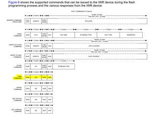

I am trying to test the primary bootloader for my AWR1843 board so I put the radar in SOP mode 5 then I tried to send a ping command through the "Hercules" interface as shown below :
I used this document for support : IWR6843 Bootloader Flow
am I not supposed to receive ACK response from the radar 0xCC  as shown in the table because as you can see in the interface I received nothing upon sending the ping command, is there any help with this? Thanks

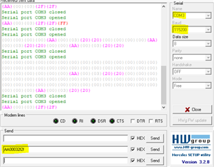

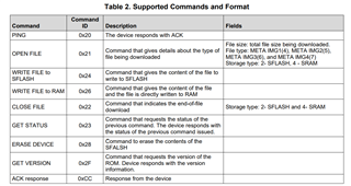

  • Hi Cesar, I tried to send this command with hercules
    which is the ping command I found in your documents here :
    but I received no response as well ...
    One more thing to add, Cesar, is that when I changed various values of Baudrate ( less then 56000 ). I kept getting different responses as the figure below shows

  • Hello Cesar, thanks for answering,
    one thing that's bothering me is that the radar is returning different responses with different baud rates for the same ping command I am using that's why I am assuming that I am sending the command right because the radar is returning values it's not like it's not responding at all.
    for example here as you can see I got {F4}, {FE} and {28}{E8} for baud rates 14400, 4800 and 38400 respectively. I got {A9} for example for the 19200 baud rate though I get no response at all for the specified baud rate of 115200

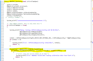

  • Hello Cesar,
    for the last couple of days I've been trying to use the QSPI driver to read the content of the flash ( of the bytes I sent into the bootloader ) si I added the flash read function at the beginning of the MmwDemo_opensensor API in the MSS main like this :
    I put a breakpoint there to be able to read the readBuf buffer which is the flash buffer but I keep getting an empty buffer
    PS : the EVM is in the functional mode of course when I am debugging
    any idea?
