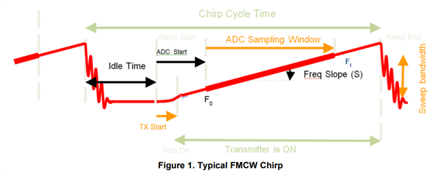

    By configuring the profilecfg command the parameters of the chirp, including idle time and adc start time seen in the figure below, can be configured. The modifiable configurations are detailed in our SDK user's guide on page 19 which can be be found at C:\<sdk download location>\mmwave_sdk_03_05_00_04\docs

    I assumes that I can configure the number of chirps in a frame by setting <number of loops> in <frameCfg>, which is 2 in the demo. Thus, according to the attached figure, there should be two chirp cycles in each frame. My question is if there will be any gap between those two chirp cycles in one frame?

    I believe the only gap between these two chirps in one frame can be configured by modifying the Idle Time <idleTime in profileCfg> and the ADC Valid Start Time <adcStartTime in profileCfg>. Since <numLoops in frameCfg> is set to 2 there will be 2 chirps per antenna. Then the rest of the frame time is used for processing and waiting for the next frame to start.

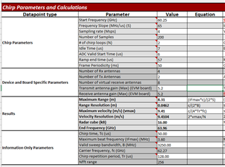

    For further information, below are some approximations of the statics of this demo determined by using the equations from the documents linked. Now this is an ideal case approximation which is mean to give an idea of what the scene parameters may look like with this config.
