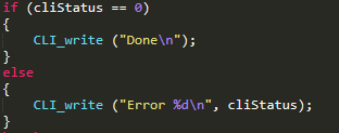

  • Hi Alec,
    I have a couple of questions
    1. Do we need any start-stop bits to be added while sending the command?
    2. What acknowledgment is expected from EVM when the command is sent?
    3. "sensorStop" is the first command to be sent and "sensorStart" is the last?
    1. I've screencapped the TeraTerm settings that I use for the CLI port below
    2. Typically, the CLI driver will echo what you are typing (so that it can be human-readable in a terminal) and once you have sent the command (must end with \n) it should reply with "Done" once the command is successfully executed, or will respond with an errorcode. I will share a screenshot below of the relevant piece of code from the CLI Driver.
    3. Not necessarily. We do this in our included files so that if you send multiple configs back-to-back, it will stop the device, flush the old config, enter the new configuration, and start the device. You may be able to skip some of those steps depending on your usecase if you desire.
    One piece of advice that I may offer, if you are looking to make a custom tool to interface with our CLI interface, it may be best to just manually connect via a Serial Terminal and send a few config files by hand and capture the logs so that you have a reference to compare against when creating your tool.

  • Hi Alec,
    Thanks for all the info it helped a lot.
    I am able to send the config chirp and get the desired acknowledgment for all the commands except the last one "sensorStart".
    Instead of "Done" or "Debug: Init Calibration status = ox7fe",  I am getting Error -1 message
    Please help me solve this

  • Samidha,
    I also just copied your configuration and tested it on my device locally, and saw no issues when using teraterm. Did you ensure to reset the device before sending the config? The 3D People Counting does not support reconfiguration, so if you send a cfg after the device has already been configured, it would likely get an error.
    Alec
  • Hey Alec,
    Yes, I got it after resetting the device.
    It seems the IWR does not take the command in the middle of runtime.
    We have to reset it and then send the config.
    Thanks, it works!!
