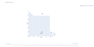

    You would have to get a significantly stronger magnet or reduce the distance between the magnet and the sensor. Here are the results of a quick simulation based on the parameters I obtained from you.
    The peak field wouldn't even be enough to trigger the lowest sensitivity TMAG5111. The gain on the MLX might help you to be able to detect the signal from that distance but I would be concerned about SNR present. Is 30cm your target distance or are you able to move the magnet closer to your motors magnet. Also you can look into TMAG5170 if you are looking for another 3-axis linear, we have other sensitivity offerings on this device that might fit your needs better.

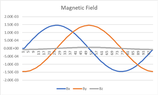

  • This is what I did with a small BLDC motor that I wanted to replace the TO-92 sensors on. I measured the field where I wanted to place the surface mount components to see if the field generated at that point was enough to work with the motor I was looking at.
    The red circle is where the previous sensors were located (just on the bottom side of the motor). And below is a picture of what the field looked like when I would measure from the distance I was going to place the sensors: (ignore the spikes this was me manually moving the rotor while still making a measurement)
    So I determined the field was strong enough to change the through hole components to some surface mount ones. With great performance.

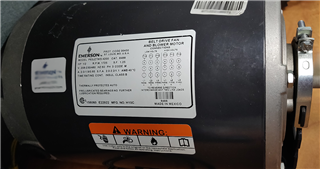

    The AC motors we are using don't have any magnets inside.

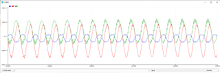

    This is the result I get from the current MLX90393. The sensor is outside of the motor. I think the metal enclosure makes it a bit difficult to read the rotating magnetic fields.
    * This is not out target motor, just one we are using for testing.
    *Running at 15Hz.

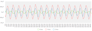

  • Hi Isaac,
    I am not really an expert in electric motors, I believe there are some new AC motors with permanent magnets but I don't think it's the standard. They need a specific drive to run and we can't just plug them on the wall.
    In the AC induction the stator windings produce the rotating magnetic field which turns the rotor. The rotor is usually a squirrel cage where the bars are shorted, like picture below:
    You are right, the magnetic field that I am picking up is from the coils.
    This is anexample from another electric motor:

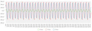

    Usually this signal is not smooth, I am using Savitzky–Golay filter to reduce noise.
    I tried the TMAG5273 A1 today and it's still not enough. My only hope now is the TMAG5170.
    This is my test setup with MLX and TMAG.

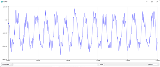

    TMAG5273 A1 raw data (only Z axis):
    MLX raw data
  • Hey Andrey,
    Thanks for the info and the quick lesson on how some of the ACI motors work.
    Based on the two images of the data that you sent over, I believe TMAG5170 should perform more similarly to the MLX device. Reason being is that TMAG5273 transmits the data using an I2C interface and when I look at the data it appears as if its just not sampling as fast as the MLX device, this should be possible with TMAG5170 since it works off of SPI interface and it was better accuracy than TMAG5273.
    As far as the devices performing angle calculations for you outside of the motor as pictured, this might not work as anticipated if you are measuring the field created by the coils. But you could obtain the frequency of the coil excitations and relate that to the motor speed. Direction could possibly be given by another one of the field components but I think there would need to be more testing involved or perhaps a secondary sensor might be needed.
    Isaac

  • Hi Isaac,
    I was finally able to test the TMAG5170, here's the result compared to MLX (COM3 at the bottom).
    Electric motor running at 10Hz, forward.
    Electric motor running at 10Hz, reverse.
    Looks like with this I can calculate direction a lot easier and the results are similar so don't need to change the way I calculate RPM as well.
