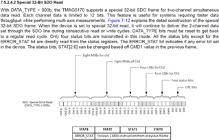

My customer try to read the Special 32-Bit SDO Read with  DATA_TYPE  2h = 12-Bit XZ data access.
They found different behavior from datasheet description as below.
Could you check the following behavior?
Datasheet description
bit31-24  Eight MSBs for ch2
bit23-16  Eight MSBs of Ch1
bit15-12  Four LSBs for Ch2
bit11-8   Four LSBs for Ch1
bit7-4    Four status bits
bit3-0    CRC bits
Acutual Log  (example)
0f000407 4000000a          #disable CRC
00203c00 4000000a         #4x, Active trigger mode, Temp channel enabled
01c38000 4000000a         #XZangle, XYZYX, X:150mT Y:150mT Z:150mT
03010000 4000000a         #ALERT on conversions done
02000000 4000000a         #Default 32-bit register access
80000010 40203c03         #Start of conversions at the CS going high
02000000 4f000018          #Default 32-bit register access
89000000 4ffa2c11          #X_CH_RESULT
8b000000 4fa1d81e         #Z_CH_RESULT
02008000 4f000018          #12-Bit XZ data access
80000010 1a1fad22         #Start of conversions at the CS going high
They think, if the dataheet is correct, it should be a1fad2xx.

    Thank you for reaching out on E2E.  There is an error in the current version of the datasheet, and a correction is in progress.
    The proper format for the special read mode should be:
    bits 31-28: Status Bits
    bits 27-20: Eight MSBs for Ch2
    bits 19-12: Eight MSBs for Ch1
    bits 11-8: Four LSBs for Ch2
    bits 7-4: Four LSBs for Ch 1
    Bits 3-0: CRC bits
