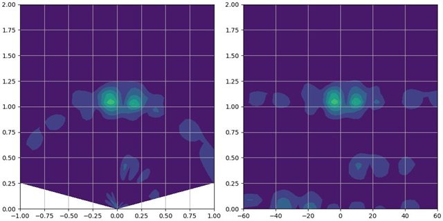

Hi, I am having an issue where the Azmath Heat Map I am displaying from the AWR1843Boost has a lag that gets progressively worse. I am operating the AWR1843 in factory demo mode i received it in. I suspect that the display is due to a backlog of Data from the AWR1843 but could be wrong. I am not sure where to go from here to debug this issue.
I have tried increasing the frame period in frameCfg to 0.8 which I assumed would account for any delay in the serial communications. It does not seem to have any effect on how fast the lag builds.
With only the rangeAzimuthHeatMap enabled in guiMonitor the lag builds to about a second almost immediately and within 5 to 10 seconds becomes unmanageable.  When I enable rangeDopplerHeatMap in guiMonitor the delay can take 30 to 60 seconds to become unmanagable even though I am only reading/displaying the rangeAzimuthHeatMap data.
I have tried to clear the data serial buffer with flush() and flushInput() but the data stops after about 10 seconds of displaying data.
I have also tried to sensorStop and sensorStart 0. This works for once cycle, but on the second or third time something goes wrong and no data is displayed.
I am not sure if there is an issue with my code or the config file.

            if tlv_type == MMWDEMO_OUTPUT_MSG_AZIMUT_STATIC_HEAT_MAP:
                ################Have also tried this to prevent displaying to often. #######
                ReadTime = time.time() - TimeOfLastRead
                print("Time: " + str(ReadTime))
                if ReadTime <= 0.4:
                    return 0, 0, 0, 0, 0, 0
                numTxAzimAnt = 3
                numRxAnt = 4
                numBytes = numTxAzimAnt * numRxAnt * configParameters["numRangeBins"] * 4
                numBytes = 12288
                q = byteBuffer[idX:idX + numBytes]  # single dimension array of the data.
                idX += numBytes
                # qrows = numTxAzimAnt * numRxAnt
                qrows = 12
                # qcols = configParameters["numRangeBins"]
                qcols = 256
                NUM_ANGLE_BINS = 64
                # NUM_ANGLE_BINS = 128   # Seems to be more accurate?
                # Specifying a Stride in a String Slice    Start:End:Skip
                real = q[::4] + q[1::4] * 256
                imaginary = q[2::4] + q[3::4] * 256
                real = real.astype(np.int16)  # Assign type to array
                imaginary = imaginary.astype(np.int16)  # Assign type to array
                q = real + 1j * imaginary  # Sets up imaginary number from data
                q = np.reshape(q, (qrows, qcols), order="F")  # Reshape from 1 dim array to 2 dim array. 12x256
                Q = np.fft.fft(q, NUM_ANGLE_BINS, axis=0)  # One-dimensional discrete Fourier Transform Q 64x256
                QQ = np.fft.fftshift(abs(Q), axes=0)  # Shift the zero-frequency component to center of spectrum.
                QQ = QQ.T  # The transposed array.  QQ array 256x64
                QQ = QQ[:, 1:]
                QQ = np.fliplr(QQ)  # Reverse the order of elements along axis 1 (left/right)  Is a 256x63 array
                theta = np.rad2deg(
                    np.arcsin(np.array(range(-NUM_ANGLE_BINS // 2 + 1, NUM_ANGLE_BINS // 2)) * (2 / NUM_ANGLE_BINS)))
                rangeArray = np.array(range(configParameters["numRangeBins"])) * configParameters["rangeIdxToMeters"]
                CartX = np.outer(rangeArray.T, np.sin(np.deg2rad(theta)))  # Is a 256x63 array
                CartY = np.outer(rangeArray.T, np.cos(np.deg2rad(theta)))  # Is a 256x63 array
                # np.concatenate(posX)
                ThetaX, RangeY = np.meshgrid(theta, rangeArray)
                np.savetxt('/Users/isaacwilliams/Desktop/Working.nosync/RadarImage/RadDataX-' + str(figure_no) + '.txt',
                           ThetaX, fmt='%.1f', delimiter='\t')
                np.savetxt('/Users/isaacwilliams/Desktop/Working.nosync/RadarImage/RadDataY-' + str(figure_no) + '.txt',
                           RangeY, fmt='%.1f', delimiter='\t')
                np.savetxt('/Users/isaacwilliams/Desktop/Working.nosync/RadarImage/RadDataQ-' + str(figure_no) + '.txt',
                           QQ, fmt='%.1f', delimiter='\t')
                np.save('/Users/isaacwilliams/Desktop/Working.nosync/RadarData/QQ-' + str(figure_no) + '.npy',
                        QQ)
                np.save('/Users/isaacwilliams/Desktop/Working.nosync/RadarData/ThetaX-' + str(figure_no) + '.npy',
                        ThetaX)
                np.save('/Users/isaacwilliams/Desktop/Working.nosync/RadarData/RangeY-' + str(figure_no) + '.npy',
                        RangeY)
                np.save('/Users/isaacwilliams/Desktop/Working.nosync/RadarData/CartX-' + str(figure_no) + '.npy',
                        CartX)
                np.save('/Users/isaacwilliams/Desktop/Working.nosync/RadarData/CartY-' + str(figure_no) + '.npy',
                        CartY)
                dataOK = 1
                TimeOfLastRead = time.time()

This is my displayed data. Only showing 2m of the 20m.
    Yes, we think this is an issue with your custom GUI.
    We have not seen this feedback with the TI GUI.
    I recommend that you also try to record this data to a file and check the behavior
