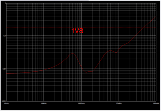

I plan to run PI AWR2944 simulation, may I know what is the target PDN for AWR2944?

I think the max frequency of supply ripple specs in AWR2243 spec is only 6.6MHz, Is there any risk if the max frequency of PI simulation only 6.6MHz?

I give one example, The ripple voltage for 1.0V is 7uVrms @137.5KHz in aWR2243 datasheet, and the peak current for 1.0V is 2.3A . So do you means the impendance <= 7uVrms/2.3A=3 u ohms @137.5KHz.
I don't think it is possible that we could control the impenance within 3 u ohms.
According to the HardwareDesignChecklist_v1p0_AWR2944 ,which could be found in sprad30, the 1.0V supply should have <=25mohms DC resistance. So there means when frequency increase, the ac impenance would also increase.

For 1.2V AC ripple is not critical. Only DC impedance is important. You can take the peak DC current and the min voltage spec for 1.2V and limit the impedance accordingly. For min voltage you also need to consider the voltage regulator tolerances etc.
