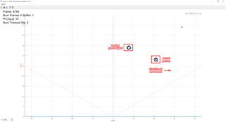

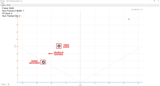

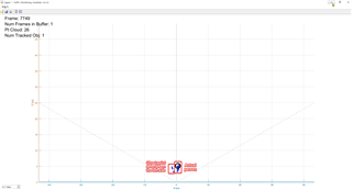

As a result of the test, several types of ghost objects were observed.
Case1. Observed from the left side of the real object.

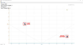

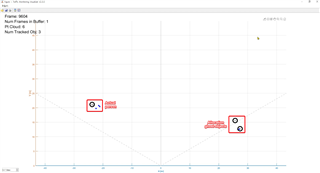

Case2. Observe from the opposite angle at the maximum detectable azimuth
Can I get some advice on what causes ghost objects and how to remove them?

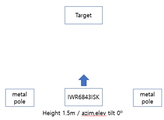

    By the way, I tested it in an open area to reduce multipath reflections (Ghosts).
    Below is my test environment
    (The distance between the IWR6843ISK and the metal pole was about 1 m)
    Could multipath reflections are caused by a horizontally positioned metal pole or ground?
  • It's certainly possible, but I cannot really confirm or deny it. If you could test in an environment without the poles present that would likely be able to confirm/deny it.
