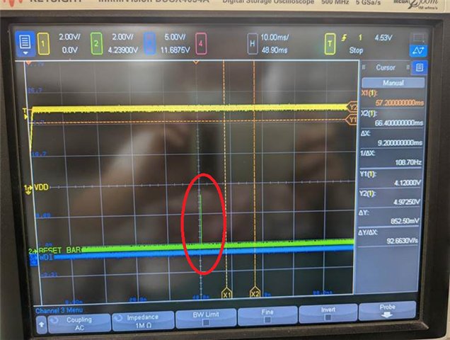

Hi all,
     It is configured the R4 pin of AWR6843 with following code.  But there is a glitch observed on the output of GPIO (as marked in following figure.). Is there anything we missed while configuration ?
    Pinmux_Set_OverrideCtrl(SOC_XWR68XX_PINR4_PADBF, PINMUX_OUTEN_RETAIN_HW_CTRL, PINMUX_INPEN_RETAIN_HW_CTRL);
    Pinmux_Set_FuncSel(SOC_XWR68XX_PINR4_PADBF, SOC_XWR68XX_PINR4_PADBF_GPIO_31);
    GPIO_write(WDI_PIN, 0);
    GPIO_setConfig (WDI_PIN, GPIO_CFG_OUTPUT);
