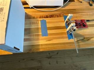

  • Okay so I have managed to get calibration up and working with the MSP430 launchpad. From what I understand so far there are differing levels of calibration, at a minimum it seems that Illuminated crosstalk and phase offset calibration are required for a new design. It seems these steps get performed when running INLAB_STEP_1 in the SDK.
    After performing this step on a stock OPT3101EVM I do not seem to get valid distance results after calibration in the live view. So I have a few additional questions to help assist in debug.
    First some extra info on my calibration setup and SDK configuration:
    Calibration Setup
    Calibration distances of 150mm and 500mm.
    SDK Configuration
    main.cpp
    #define INLAB_STEP_1 //simple bring up
    OPT3101_configurations.cpp
    Using generated file from configuration tool. I had to make a lot of assumptions here because I don't have a configuration file for the stock OPT3101EVM.
    Questions:
    1. Assuming a non changing ambient temperature and ambient light conditions, is Illuminated crosstalk and phase offset calibration only sufficient for basic testing?
    2. After performing calibration "dev.resetInitAndViewData(3000, true);" is called. This function seems to reset the device. Won't this clear the coefficients that I just wrote into the OPT3101 during the calibration?
    3. Can you provide a the OPT3101_configurations.cpp for the OPT3101EVM? I would like to compare it to the one I generated.
    4. Any other suggests for debugging?

  • For those out their that run into a similar problem that I did, here is the solution:
    When running "#define INLAB_STEP_1 //simple bringup" in the SDK in order for you calibration to take effect without having to hardcode coefficients into OPT3101Coefficients.cpp and recompiling, use the following in main.cpp:
    #ifdef INLAB_STEP_0
        dev.resetInitAndViewData(3000, false);
    #endif
    #ifdef INLAB_STEP_1
    	dev.calibrationSession_firstTimeBringUp();
    	//dev.resetInitAndViewData(3000, true);
    	dev.liveDataView(3000, 100, false);
    #endif
    The SDK by default calls dev.resetInitAndViewData(3000, true); after performing the calibration dev.calibrationSession_firstTimeBringUp(); This function resets the device clearing the calibration you just performed and then loading the hardcoded coefficients in OPT3101Coefficients.cpp.
    Rather I added dev.liveDataView(3000, 100, false);. This function initiates live view without resetting the device so you can see the results of your calibration without the hassle/confution mentioned above.
