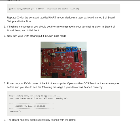

There is a picture that I have attached it is a document listing the steps to turn on the visualizer but I am not able to achieve step six, I have doubt about step four and five like when I added the CFG file, what path should I choose?
  • HI,
    As mentioned in the documentation, it is the path to the config file you have modified

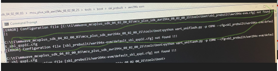

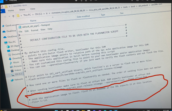

  • edited file: (named:default_sbl_qspiC.cfg) by the way, am I editing correctly? I mean I edited from original by erasing everything after "# file= " and replaced it with path address. it was (send the application image to flash. Flash it at OxA0000 as the SBL expects it at this location
    #file=...\...\example\ something something --operation=flash --flash-offset=0xA0000) and replaced it as you can see below. I hope this is correct...
    #file= C: \ti
    cmd command: (look at the output it’s giving)
    C:\til mmwave
    mcuplus_sdk_04_02_00_03\mcu_plus_sdk_awr294x_08_02_00_25\tools\boot›pythonuart_uniflash.py-pCOMG --cfg=sbl_prebuilt/war294x-evm/defaul
    t_sbl_qspiC.cfg
    ¡[ERROR] Configuration file [sbl_prebuilt/war294x-evm/default_sbl_qspic.cfg]not found !!!
    Yes I did What’s exactly told but why the cmd says config file not found?

  • no i didnt know, so is it same as CCS? I have CCS.. I thought CCS is supposed to do the flashing.. so after i download uniflash tool, what are the steps to run the visualizer?
    So if i download uniflash tool, what do I do with the rest of the steps like 7 & 8?? like when i turn on the EVM, which mode should I put? UART or QSPI?
    it would be nice if i could also follow the userguide, but if you say just use uniflash tool, please let me know the further steps as well because it is not in the handout.
    Step 1 - Identify the COM ports used by the EVM (Device Manager)
    Step 2 - Power off EVM, Configure SOP switch/jumper on EVM for Flashing Mode
    Step 3 - Power on EVM, Start Uniflash v 7.2.0
    Step 4 - New Configuration -> AWR2944, Start
    Step 5 - Settings&Utilities -> COM Port: Fill In Application/User COM Port
    Step 6 - Program: Browse to SBL and App Image
    Step 7 - Load Image
    Step 8 - Power off EVM. Configure SOP switch/jumper on EVM for Functional Mode

    When a file is not found it is a path issue.
    Make sure you have initialized the environment as requested in the documentation.
    Also make sure that you are using correct (forward/back slash) as needed
    thank you
    Cesar
  • Oh I see that I’m using forward slash where as command line is using backward slash, just to be safe which one am I supposed to use in windows 10?
    the document says: “Simply add the path to the demo you want to flash in the above following line. Leave everything else
    the same”, she didn’t specify which path to choose so I chose my own “file= C: \ti” is this correct? I wrote this by replacing/erasing whatever it was written in the original file (default_sbl_qspi) after file=
    am I supposed to erase all that? If I can choose any path I don’t see any mistakes do you?
