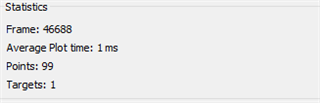

  • Thanks Nathan,
    I am able to find the .cfg files for the sense and direct/3D people counting.
    However, during the launching and execution of the lab, sometimes, the program freezes.
    This includes:
    1. Unable to send commands to the evm
    2. freezes after some execution. There is no error message given
    3. for 3d people counting, it freezes with this error message:
    This occurs after execution for a few minutes.
    The configs are taken from sense and detect/3d people counting lab. Is there a way to prevent such issues from happening?
    Thank you for your assistance.

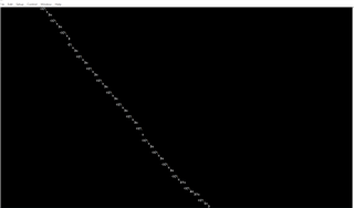

  • Hi Nathan,
    I have also tried to send the output to tera term with baudrate of 921600. The output is as such:
    How do  you decode the data?
    Thank you.
  • 1. Unable to send commands to the evm
    When all the console prints is b'', it's likely because the EVM hasn't been reset, or it's still in flashing mode.
    Sometimes the GUI will freeze if it's unable to keep up with the device. If you run lots of memory intensive programs with the visualizer this is more likely to happen.
    Does this happen every single time? I've been running the visualizer for stretches of 5-10 minutes without it failing. Sometimes it misses a TLV which leads to the parsing error, but that shouldn't crash the program

    I set the sensor output com port to such configuration at baudrate of 921600.
    Then I ran the device. I got the output on terraterm and downloaded its log into a txt file.
    This is the result I had gotten:
    B
    í»íæÈkS^3IÚ ²¼ú~*?u¿=ÌL¸=>VF2PH­PI(NGÃNRWLkKQAI\Cm?n:;]9C88A)6x4B>33(0[¬/\n.8-FE-X+,]È+G(z?"&Å6³p¢YCZd~'Bn)()×L
    ]4opXknm©^+lij=Û08/züJMû[ûI!ø5ê÷4"÷6Uô ­ô@EôAEð2ð Nð
    ÂèfPèp¸ço¸æ4åg8ä3¤äNøäQ8äqAâzâ,)âM¿áàÃà0öß/ÞnMÝ.¨Ü-cÛ^+×#Ó49лÐÐ ¦Ï
    È.È*JÇKÇ)«Ç@DÅO-ÅRoÄ(NÄ3(Á,¿ÁSJ¾93½N±¼-i¼T:»:(»M­¯,B
    ÷fçàlSr3ï¬ú~*?u¿=ÌL¸=>UF5RI3PG¸PHNcNR*H}A><Y<@18A)7Zy7m05¬4B6/[.W+.X<.\-),F>)G½)]'H#&º{³1IWYqÎ+ZEno'P(Q)æIo÷hJp kki?jMl£m108/zþ3ýI¥ýJeúø47÷5¾÷6Qô@YôA@ó ?ò
    1ð Óð
    ãïçf,çoáçpåNXä3³äQ6äqã.ãM÷ââ?á,-à¥à0öß/ßnÞ.¿Þ^CÛ-lÖÖ4?ÑãѿР§Ï
    Ég:ÇaÇ*OÇ@JÇR^Æ1Æ)«ÅO?Ä(NÄf(ÂSHÁ,¯ÀQ,¾95½-f½N½`*ºMŸn.µF°®ljB
    ´ðèÎmSZ3¼ ú~*?u¿=ÌL¸=>UF9Uy-RI@QGÀObOH±HGn*BG=@/;Y8ZZ55mA3B.0XI.0.[ý-F<-\ò*GÊ)]4(Hs"&©µI<-GÅ'ZGXnV(1)âBh<opk3iZjMlîmBm07/zþ3þI¦þJeúø4G÷5µ÷6Cöu-ô@mó óARò
    ð
    Æïéf7èpçoßæQ>åNåq/ä3©äMîã/â?áán°à¤à0ëß/Ý.¶Ý^/Û-gÖÕ4<ÑàÑÁÐ ©Ï
    Ëg7Ç_Ç4Ç*JÇ@QÇA/ÇRSÆ) ÆO/Å(PÃU*Á,À¿92¿S+¿T)½N¨¼-sºMϵ9°B
    V·èÂnSh3jÊgù?ú~*?u¿=ÌL¸=>VF6OHxNnNc2MG?MRKQXI[Ds?mj;]9C39Z87A*5 33,3B:0[F.;.\
    -X1-],F=)G§7à~n]t9ZQ7'E()Ô^ pdo*khlbm¨i?jN08/~üI
    úùJ^÷4÷5÷6.õ@7ô µôAFð>ð gð
    ÏèpÆçf4çoËä)ä3äNiäQ-äg+ãMÕãq4âG-ááà×à0äß/ßnVÝ.ªÜ-aÜ^)××:/Ó4;мÐÐ Ï
    ùÈ2È*OÈA(ÇQÇ)°Ç@LÆR®Ä(PÄO8ÃSOÂ,Ѿ92½Nü-n¼TD»:)»M´¯-B
    PéÂoSp35BÇ`?ú~*?u¿=ÌL¸=>UF?SI;QGÈP_POUOH¶HvBABn6>@.;]9A*9Z[63B/1XS1m8/[Û.2-FD-\©*G×*]'Hw"&ÔyIA-\»ZYT'NnU())á; o9h8prk7iOl+j%mDg/{06þ3þIÑýJpú#ø4C÷5²÷6?ô@hó óASò
    How could I decode the data/ what is the best way to receive the data with open source tools.
    2.Also, when I am running sense and direct lab on the GUI,
    I have encountered the following error:
    After which, the python GUI stops updating. The number of frame stays stagnant too. Only the number of points keeps changing.:
    How can I prevent this from happening?

    You are running the GUI for 47000 frames, which is quite a lot. This is approximately 47 minutes. Does it only happen after quite a while? Or immediately? It may be a limitation of the PC you're running on.
