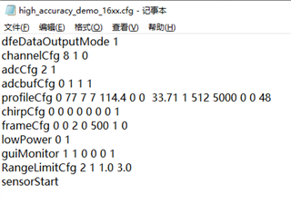

Customer use mmwave_industrial_toolbox_4_7_0__win\mmwave_industrial_toolbox_4_7_0\labs\level_sensing\16xx_high_accuracy\chirp_configs\high_accuracy_demo_16xx.cfg to configure parameters for high accuracy ranging.
After completing the parameter configuration through the serial port, he sends sensorStart, but the following error message prompts:

{module#8}: "../dss_main.c", line 921: error {id:0x10000, args:[0x80dc8c, 0x80dc8c]}
xdc.runtime.Error.raise: terminating execution
Please help check.
    I checked the line of the code where error occurs
        /* On XWR16xx only channel non-interleaved mode is supported */
        if(ptrDataPathObj->adcBufCfg.chInterleave != 1)
            DebugP_assert(0); /* Not supported */
    This error is created by the following change
    channelCfg 8 1 0
    Please use the original value
    channelCfg 1 1 0
