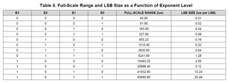

In Automatic Full-Scale Setting Mode, there are the following sentence.
 >>If a measurement is towards the low side of full-scale, the full-scale range is decreased by one or two settings for the next measurement.
>>If a measurement is towards the upper side of full-scale, the full-scale range is increased by one setting for the next measurement.
>>If the measurement exceeds the full-scale range, resulting from a fast increasing optical transient event, the current measurement is aborted.
>>This invalid measurement is not reported. A 10-ms measurement is taken to assess and properly reset the full-scale range.
Question
How does the full scale range decrease if I suddenly move from a bright place to dark place?
For example
FULL-SCALE RANGE: 83865.60[lux] LSB SIZE:20.48 (lux per LSB) in use
What happens to FULL-SCALE RANGE if I suddenly enter a dark place? (about 300 lux)
Thank you.
