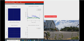

I tested OOB Demo in SDK 3.5
I detected the vehicle in front and observed the result using IWR6843ISK.
It was detected when the vehicle was moving, not when it was stopped.
The vehicle was detected from 40 m and was not detected after stopping.
The distance from the stopped vehicle is about 28 m, and when the vehicle is moving, it is detected again.

The detection result using visualizer is as follows.
A moving vehicle could be detected at a greater distance (40m), but it does not make sense that it is not detected when it is stopped.
Any advice on why the static object is not being detected would be appreciated.

  • Hello Jinhyeong.
    The reason why the vehicle is not being detected, it is very difficult to detect static object due to the way it works.  When a chirp is sent out and reflects off a moving object, it returns with an added doppler shift, and this change of frequency is what is used to detect an object.  However, if an object is static, it is no different from any other static object in the field of view, such as a tree or a lamp post, as the reflected wave is the same as the transmitted wave except with a potential phase shift.  And since it is very far away, there may not be enough points within the range bin for it to deem that something has been detected in that area.  However, the moving object shouldn't be picked up by the zero doppler graph as it no longer has zero doppler and shouldn't be detected, so it may be that the second point at around 35 meters may be something else and not the car.  The traffic monitoring demo and the long range people detection demo, in comparison to out of box, may be more helpful in trying to pick up objects as they use a tracker which will continue to pick up on static objects better.  The area scanner demo also has additional processing that can improve static detections in a given scene.
