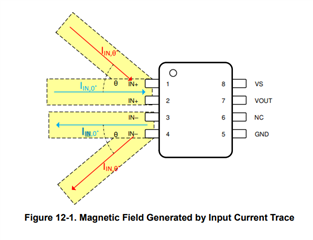

TMCS1108: Recommend value for θ.
Guru 11295 points
Part Number: TMCS1108
Hi team,
Is there a recommended value for θ (Theta) ?
If you have, I'd like to know MAX and MIN.
Sincerely.
Kengo.
  • Kengo,
    Thanks for using E2E!
    If possible, the recommended angle of approach for current (theta) for the device is 0 degrees, or directly into and out of the device. While its not quite the same test, we ran a bifurcation style test in section 5.2 of this app note you can check out, where it shows the contribution of a current carrying wire at varying lengths from the device.
