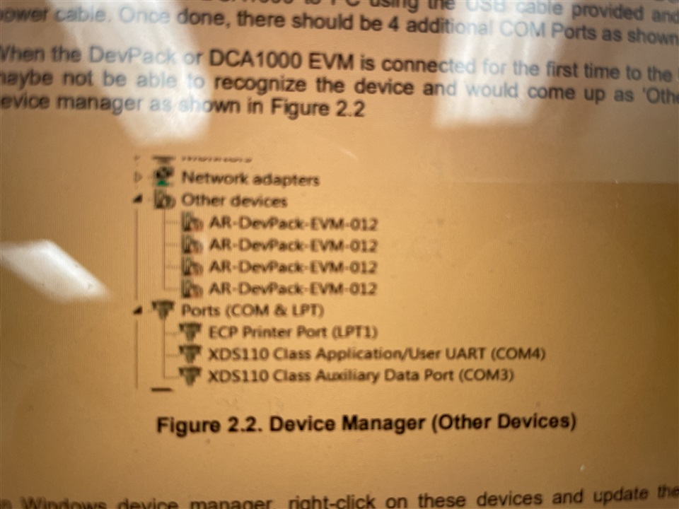

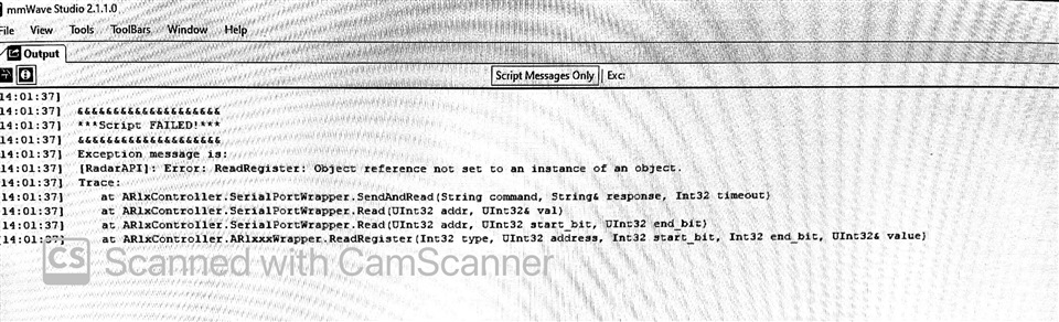

  • Ok, so one thing before this i think is why my device manager not detecting other devices??
  • According to the document link that I posted
    I followed each and every step so if you are going to ask about things that I downloaded, I downloaded mmWave studio, I downloaded FTDI driver, I already had CCS, I already had mmWave sdk, I already have matlab. So what is missing?
    (I downloaded CCS and mmwave SDK because I had another board does that make a difference? The document doesn’t talk about these two software’s so is it necessary for me to have these software‘s?)

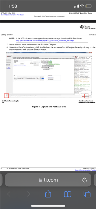

    Please make sure to follow all the instructions provided in
    "2. mmWaveStudio Installation and Startup"
    C:\ti\mmwave_studio_03_00_00_14\docs\mmwave_studio_user_guide.pdf
    Please also make sure the DCA1000 is configured as described in
    C:\ti\mmwave_studio_03_00_00_14\docs\DCA1000_Quick_Start_Guide.pdf
    Thank you
    Cesar
  • I am sorry but but what does configure mean exactly?
    How do we do this step: Issue a board reset and connect theRS232COM port
  • Board reset means power off/on the board
    thank you
    Cesar
  • So I took a new computer and started from scratch. (Previous computer had awr2944 setup successfully done)
    I followed the steps your document has: installed mmwave studio, ftdi driver, matlab2015a, visual C++.
    now my computer doesn’t even show UART comports(UART port showed in my previous laptop). Both computer doesn’t show the four AR-Dev pack-EVM-012 device yet & that’s my problem
