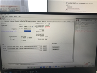

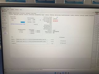

Thanks. I have installed XDS Emulation Software Package 9.2.0.00002 and ccs_setup_12.0.0.00009, XDS110 still is no any alerts in device manager.
So just to confirm, when you plug your ISK in with it being in flashing mode, by no driver alerts you mean you do not see any new COM ports show up in Device Manager? Do you have the ability to try a different USB cable, and do any LEDs turn on when you connect the ISK? Even if the ISK is in the wrong mode when connecting to a computer, you should still see the COM ports and some LEDs turn on.
Pedrhom Nafisi
Thanks. IWR6843ISK Rev D needs to install driver in www.silabs.com/.../usb-to-uart-bridge-vcp-drivers. The Silicon Labs Dual CP210X has been installed successfully. But now, the COMs named AR-Devpack-EVM-012 are missed in device manager.

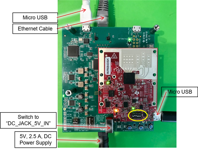

Glad to see the COM ports appearing now, those two ports are the DATA and CONFIG ports and are the two that should pop up. One thing I see is that you should try having your ISK + DCA1000 switches match all the ones in this photo below.
Also, set your RS232 Operation port to the COM that says Silicon Labs Dual CP2105 USB to UART bridge: Enhanced COM port and try again.
