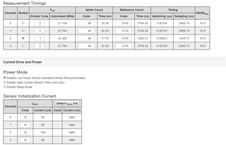

  • John,
    I have the connected the EVM right now to the GUI, and it this is the report. The only thing i change was the Idrive code for CH2. I saw somewhere in the forum where it recommend to used code 16. Hence I'm using that.  And in the above explanation I had meant to say ~5.0MHz. Apologies for the typo.
  • Sushant,
    I checked with one of my colleagues for a reality-check and he reminded me of an important consideration for these devices.
    They are not like conventional data converters; the sensor is a tuned circuit - with a finite bandwidth - that provides the FDC device input.
    As you know, the varying sensor capacitance causes a shift in the resonant frequency and this is what the device measures (by design).
    These devices are really intended to measure a change in capacitance, and not a precise value of a fixed capacitance.
    You will most likely need to experiment with different values of the EVM's lumped-element L & C to get the capacitance shift you are looking for.
    These tuned circuits have bandwidths that must be considered, and you can do that with the well-known, simple equations relating R,L,C and Q.
    Otherwise the sensor capacitance range may exceed their input circuit's bandwidth. That may be what is happening now.
    You may have seen it already, but there is some information in one of the later sections (10.2.4) of the  FDC2214 data sheet that may help too.
