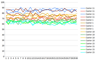

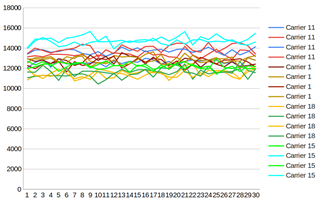

Hello hope are you good, I have a custom boards when I used opt3101 but I have a big problem the measures are not the same, in theory I am using the same photodiodes in all my boards.
I did the calibration as you said but I can't solve the problem, can you help me? Is there any mathematical method with which I could correct those offsets?.
The measurements shown in the following pictures are from 3 different boards, as you can see, the measurements have a large offset error.
I hope you can help me, greetings
                             Phase                                                                                           Amplitude
