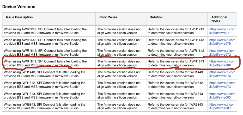

I am referring to the guide that helps sold my problem but:
is this the correct link highlighted in red? It says AWR1843 but mine is AWR1843Boost here is the link:www.ti.com/.../swrz089c.pdf

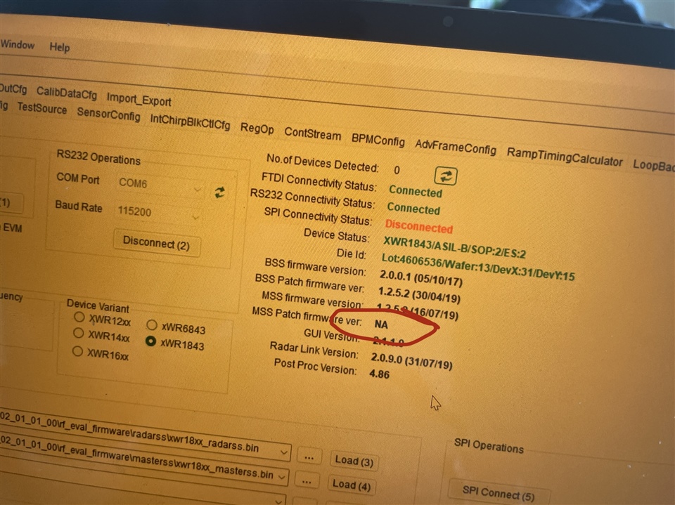

I can’t find my silicon version
after I find it, what should I do next?
