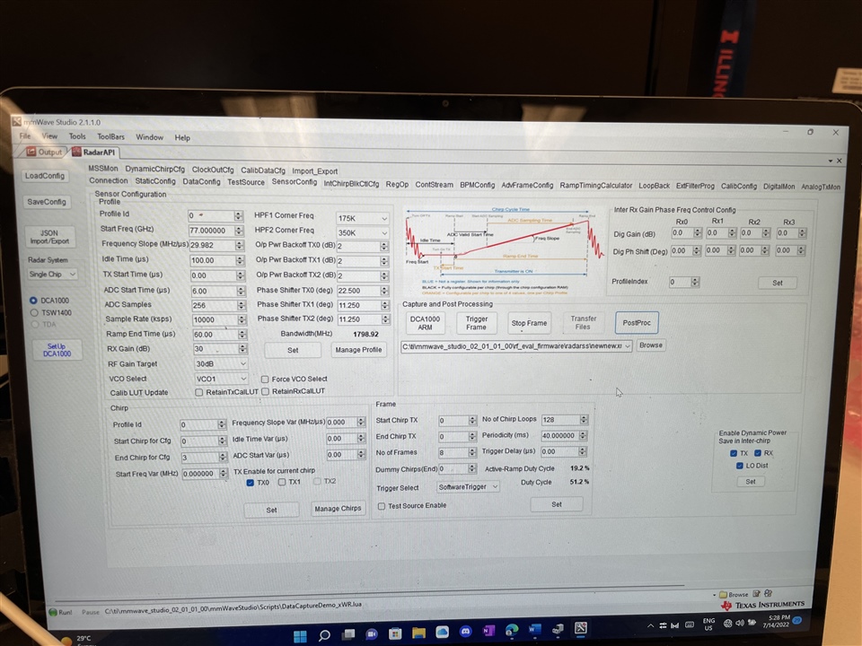

When I click on Postprocess button, why nothing happens? No response? There should be a graph coming out…

Please make sure to following installation user guide. The correct matlab run time library version must be installed

You mean this right? I downloaded MATLAB run time engine from this installation user guide already..
I followed the video guide on how to open post processing after setting up all the parameters https://m.youtube.com/watch?v=z06C2W6qMc8
he was able to open but I wasn’t able to open the post processing window mine gives no response.
I hope it’s not because of my computer, I have 8 GB ram, intel i7
Can you please check that the raw data is present in the capture folder?
