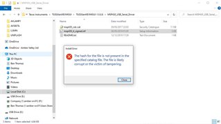

I've recently purchased a BOOSTXLTUSS4470 and MSP-EXP430F5529LP, I've downloaded the GUI and stacked them up as in the guide. The GUI says no TUSS4xx0 device detected and when attempted to flash the launchpad micro there's a binary programming failure attached is an image of the GUI window. LED102 on launchpad is lit, D3 and D2 are lit on BOOSTXL board.

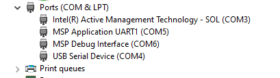

    When you were doing reinstalling the GUI did you completely clear the previous install files and retry the reinstallation? Can you open device manager and check if the MSP is communications with the PC. When connected properly it looks something like the image below.
    We need to ensure that the MSP is connected to the PC before doing the install, this could be a possibility why it is failing. Another thing to note is if all the files mentioned in the first warning are all installed.

    Below is coms in device manage.

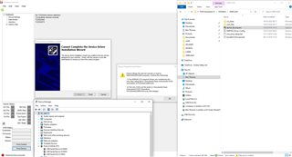

  • Hi Isaac, thank you for your help and patience on this, The U2A_TUSS.out file is in the correct location, The file you sent me made it possible for a fresh install to perform correctly but I am still getting the first error, below is a screen shot of various windows. I executed both bat files and tried the .exe file
    I also tried installing the MSP_ti_signed.inf file, result is below.

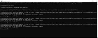

    Below is result from command prompt loading one_time_setup.bat
    I managed to get the drivers to install properly by installing the .inf files seperately in the MSP430 USB_CDC and USB_eZ_RF folder but still get original error.
