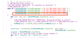

Hi experts,
In ccs, I want to achieve adv chirp config(only one sub-frame),adv chirp config refer to MMWL_advChirpConfigAll()(C:\ti\mmwave_dfp_02_02_03_01\ti\example\mmWaveLink_SingleChip_Example  mmw_example.c) Collect ADC data through DCA1000, found a problem with a TX。Discovered by testing,there is no problem with the LUT value setting. We enable TX1 TX2 TX3  separately,the transmitted waveform is captured by the instrument . Only enable TX4,the instrument  can not capture the transmitted waveform. How should I solve this problem?
I use the SDK Version(mmwave_mcuplus_sdk_04_02_00_02-Windows)
In rI_device.c ,I  modify the function of rlDevSetFillLUTBuff(). I add the TX4 and gmake ,no error
                         Figure 1

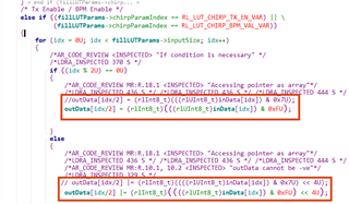

        /* Tx Enable / BPM Enable */
        else if ((fillLUTParams->chirpParamIndex == RL_LUT_CHIRP_TX_EN_VAR) || \
                 (fillLUTParams->chirpParamIndex == RL_LUT_CHIRP_BPM_VAL_VAR))
            for (idx = 0U; idx < fillLUTParams->inputSize; idx++)
                /*AR_CODE_REVIEW <INSPECTED> "If condition is necessary" */
                /*LDRA_INSPECTED 370 S */
                if ((idx % 2U) == 0U)
                    /*AR_CODE_REVIEW MR:R.18.1 <INSPECTED> "Accessing pointer as array"*/
                    /*LDRA_INSPECTED 436 S */ /*LDRA_INSPECTED 436 S */ /*LDRA_INSPECTED 444 S */
                    outData[idx/2] = (rlInt8_t)(((rlUInt8_t)inData[idx]) & 0x7U);
                else
                    /*AR_CODE_REVIEW MR:R.10.1, 10.2 <INSPECTED> "outData cannot be -ve"*/
                    /*LDRA_INSPECTED 329 S */
                    outData[idx/2] |= (rlInt8_t)((((rlUInt8_t)inData[idx]) & 0x7U) << 4U);
            addrOffset = ((rlUInt16_t)(fillLUTParams->inputSize - 4U) % 4U) + \
            alignIdx = fillLUTParams->inputSize;
            /* fill up the remaining bytes to make 4 bytes aligned */
            for (idx = alignIdx; idx < addrOffset; idx++)
                outData[idx] = 0;
        /* TX0/TX1/TX2 Phase shifter */
        else if ((fillLUTParams->chirpParamIndex == RL_LUT_TX0_PHASE_SHIFT_VAR) || \
                 (fillLUTParams->chirpParamIndex == RL_LUT_TX1_PHASE_SHIFT_VAR) || \
                 (fillLUTParams->chirpParamIndex == RL_LUT_TX2_PHASE_SHIFT_VAR) || \
                 (fillLUTParams->chirpParamIndex == RL_LUT_TX3_PHASE_SHIFT_VAR))
                outData[idx] = (rlInt8_t)(((rlUInt8_t)inData[idx]) << 2U);
                outData[idx] = 0;
