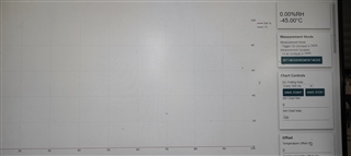

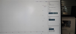

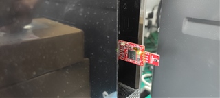

Hi Pavani Tenneti,
Sorry,I only have one EVM.I received the EVM no more than two weeks ago,I measured the temperature and humidity a few days ago and it was normal,suddenly it didn't work properly, and I found that when EVM was working properly, the red light was flashing, but now when it wasn't working properly, the red light was always on.

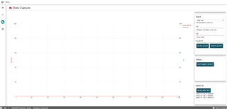

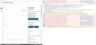

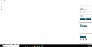

Hello Jiang,
Can you confirm if the hardware is connected on the bottom left of the screen and if the ADDR is set to 0x44?
And can you send me a screenshot of your debugger (CTRL + SHIFT+ J) when you open up the GUI and try to trigger a measurement?
