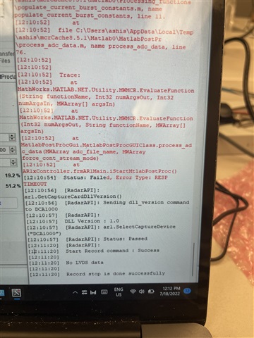

I am using DCA1000EVM and AWR1843BOOST to capture raw data using mmWave studio
when I capture data via mmWave studio, The LEDs in the top right corner do not blink continuously while capturing data (I think the data is not captured properly), and it heats up more than the other normal working board.
Also, in my board's top right LED, the second LED doesn't light up while post processing in mmWave studio
the output window shows this:
  • So, if I understand correctly
    • there are 2 DCA1000 Cards
    • Using the same PC, the behavior is different
      • One of the cards works fine
      • The other card does not work
    Is this correct?
    It seems that the error in the snapshot is due to Matlab setup and not to the DCA1000
    Are you using the same PC for capture with both DCA1000?
    Thank you
    Cesar
  • Yes.
    the other DCA1000 board is not mine though, I tried using someone else’s.
    yes one works other doesn’t.
    yes, using the same pc
    It is possible that the second board is defective
    Could you send us the full debug log?
    thank you
    Cesar
  • GM: Constructor

    [22:47:53] [RadarAPI]: ar1.GetCaptureCardDllVersion()
    [22:47:53] [RadarAPI]: Sending dll_version command to DCA1000
    [22:47:54] [RadarAPI]:
    [22:47:54] DLL Version : 1.0
    [22:47:54] [RadarAPI]: ar1.SelectCaptureDevice("DCA1000")
    [22:47:54] [RadarAPI]: Status: Passed
    [22:47:57] [RadarAPI]: ar1.CaptureCardConfig_EthInit("192.168.33.30", "192.168.33.180", "12:34:56:78:90:12", 4096, 4098)
    [22:47:57] [RadarAPI]: ar1.CaptureCardConfig_Mode(1, 2, 1, 2, 3, 30)
    [22:47:57] [RadarAPI]: ar1.CaptureCardConfig_PacketDelay(25)
    [22:47:58] [RadarAPI]: Sending fpga command to DCA1000
    [22:47:59] [RadarAPI]:
    [22:47:59] FPGA Configuration command : Success
    [22:47:59] [RadarAPI]: Sending record command to DCA1000
    [22:47:59] Configure Record command : Success
    [22:47:59] [RadarAPI]: ar1.GetCaptureCardFPGAVersion()
    [22:47:59] [RadarAPI]: Sending fpga_version command to DCA1000
    [22:47:59]
    [22:47:59] FPGA Version : 2.8 [Record]
    [22:47:59]
    [22:48:05] [RadarAPI]: ar1.CaptureCardConfig_StartRecord("C:\\ti\\mmwave_studio_02_01_01_00\\mmWaveStudio\\PostProc\\adc_data.bin", 1)
    [22:48:05] [RadarAPI]: Sending start_record command to DCA1000
    [22:48:10] [RadarAPI]: ar1.StartFrame()
    [22:48:10] [RadarAPI]: Status: Passed
    [22:48:10] Frame start async event received!
    [22:48:10] Frame End async event received!
    [22:48:10] [RadarAPI]: Frame Ended
    [22:49:30] [RadarAPI]:
    [22:49:30] Start Record command : Success
    [22:49:30]
    [22:49:30] LVDS buffer full
    [22:49:30]
    [22:49:30] Record Process :
    [22:49:30] Timeout Error! System disconnected
    [22:49:30]
    [22:49:30] Record stop is done successfully
    [22:50:02] [RadarAPI]: ar1.StartMatlabPostProc("C:\\ti\\mmwave_studio_02_01_01_00\\mmWaveStudio\\PostProc\\adc_data.bin")
    [22:50:02] [RadarAPI]: No of files Captured: 1, Total no of frames for each device : 8
    [22:50:03] [RadarAPI]: Error:
    [22:50:03]
    [22:50:03] ... MWMCR::EvaluateFunction error ...
    [22:50:03] 25-Jul-2022 22:50:03: Incorrect number of samples. We expect 262144. However, we got 162344.,1,
    [22:50:03] Error in => process_adc_data.m at line 79.

    Sorry for the delay
    Yes, it looks like there is an issue with the data transmission from DCA1000 to PC.
    Please return the board.
