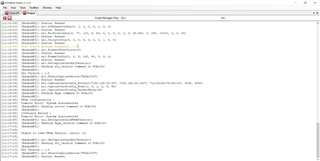

    this is what the message log says:

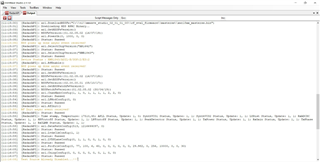

                 I was referring to the studio output window log. I am putting a snap of the same.
  • I dont have this window, where can i find it?
         In studio under View -> Output.

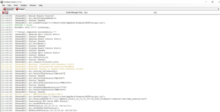

  • this is everything:
          Thanks. From the log the DCA doesn't seem to respond and causes timeout error.
