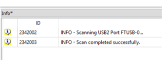

       Before flashing, was the first step of validating the connection/cable OK?
    Once that is OK, only then you will be able to Erase or Flash.
    In the second step Erase needs to complete successfully to move further as that will affirm the correct state of setup connections and GUI settings.
  • Hi Abhed,
    Thank you very much for prompting me to revisit the cable detection part.
    Following was how my cable scan output was originally (which indicates failure !) I seem to have overlooked that originally.
    I repeated the cable detection for a few times with no success. I was using a longer USB cable than what came with the board. So I swapped the USB cables and used the white short USB cable that came with the board and voila!. Following is the new output of the cable detection. As you can see all is in order now. It seems the USB cable length was the issue - not immediately obvious unfortunately :(
    I then continued onto erasing and re-programming of the FPGA as documented. All went without an issue thereafter and my FPGA now has an updated firmware.
    Now that I have gone through the pain myself, I am also including the full output of the programmer in case someone else needs to use it for reference during troubleshooting. I hope this will help others. (Please note I split the page into two as it was too long to fit onto one page)
