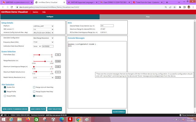

AWR1843: no plots shown in mmWave Demo Visualizer
Part Number: AWR1843

2. The SENSOR STOP button in the 'Plot' tab is not active even after pressing 'SEND CONFIG TO MMWAVE DEVICE' in 'Config' tab. What to do?

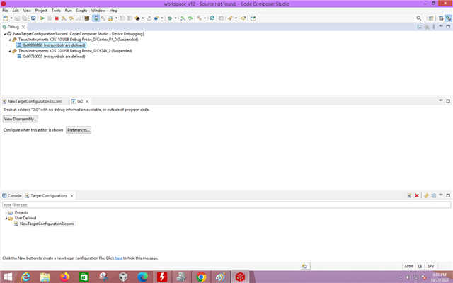

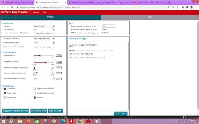

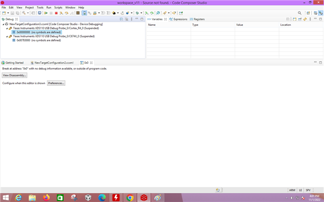

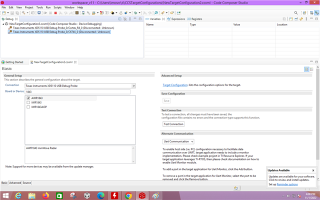

    " We did not get the error at line 209 before. All I have done is posted in my previous reply.
    If you can see both the cores in CCS are showing "disconnected: Running" after error appeared in the mmWaveSDk. So I pressed sw2 to reset the the device after CCS is disconnected.
    I have again performed the same. No error at 209 in the console window is shown this time.
    Builded demo, flashed the device, changed to functional mode and connected to mmWave SDK.

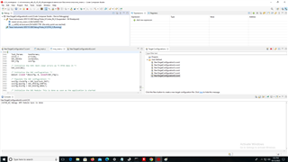

    Opened CCS. Connected to both the core and pressed reset in CCS and loaded DSS onto C67x and pressed reset in CCS and loaded MSS onto R4F. Fig. 86. Unlike before No error at line 209 is appeared in the console window.
    Ran C67X (Fig. 87)and then R4F(Fig. 88).
    MMWave Demo message appeared in mmWaveSDk (Fig. 89).
    Pressed SEND CONFIG TO MMWAVE DEVICE. Like last time it got disconnected error appeared in mmWaveSDK (Fig.90) and CCS (Fig. 91).
    You can see in Fig. 91 both the cores are showing "Disconnected:Running". Last time I pressed sw2 here, as it is showing Disconnected.
    just to make sure this time I pressed terminate in CCS and pressed sw2 on EVM and relaunched the config file in CCS.
    (Fig. 92). This time both the cores are showing "Disconnected::Unknown."
    Ran both the cores and pressed SEND CONFIG TO MMWAVE DEVICE. error appeared in mmWAVESDK and CCS。"

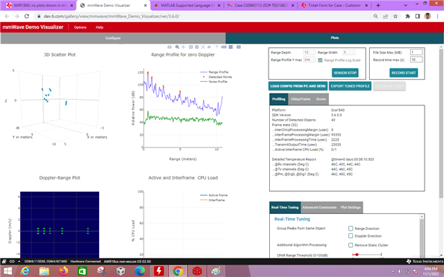

    Could you also tell the customer to use an oscilloscope to find out whether the 5V is the actual supply? Maybe try a different adapter as well? and then conduct the experiment.
    Saswat Kumar
  • Hi miao,
    Could you also tell the customer to use an oscilloscope to find out whether the 5V is the actual supply and even the current if they have a current sensor? Maybe try a different adapter as well? and then conduct the experiment.

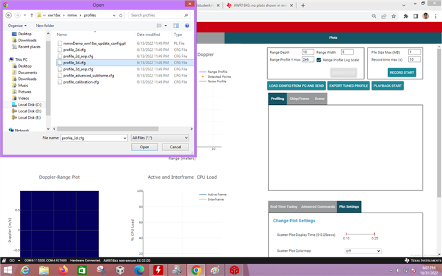

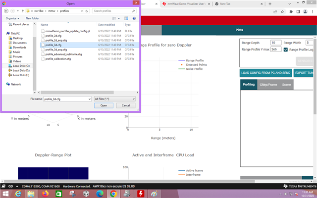

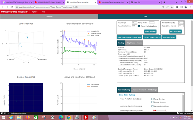

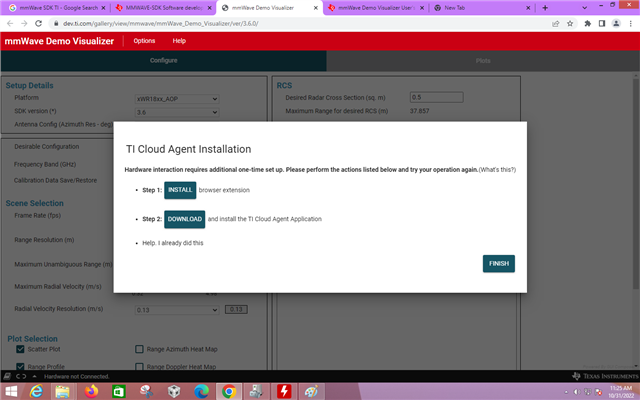

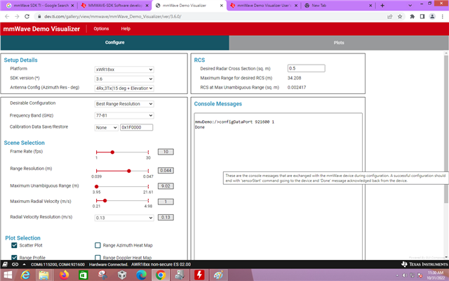

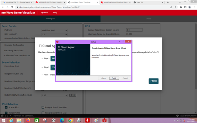

        My customer ask me to post his test result here:
       " I have tested with another power adapter of 5V,3A we were using for TMS320C6748 board. It is working. The power adapter we bought was also 5V,3A. I guess it was not compatible.
          Here is what I have done.

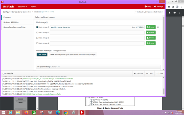

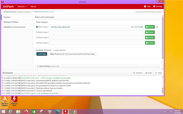

          Flashed the device (Fig.1)

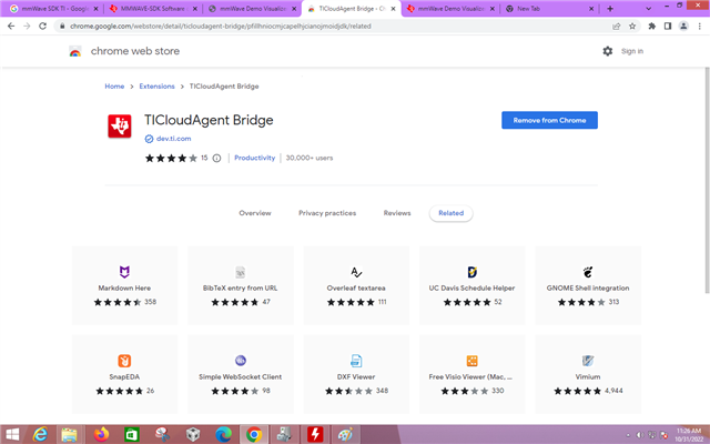

          Used mmWave SDK 3.6, As it was the first time I was using it.It prompted to install browser extension and TI cloud agent application. Did that. (Fig.2,3,4)

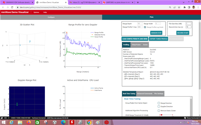

          Connected the mmWave SDK with the device. (Fig.5)

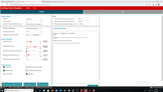

          Went to the plots section and loaded 'proile_3d.cfg'. (Fig.6)
          The plots are generated, (Fig.7).
          Stopped the sensor to load 'proile_2d.cfg' for checking.It has worked for this too.
          Checked with SEND CONFIG TO MMWAVE DEVICE from CONFIG tab of mmWave SDK. IT is also working.
           Still anything to be checked?"

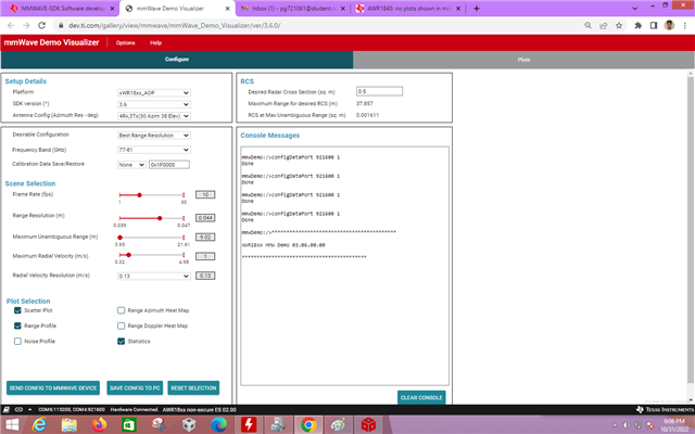

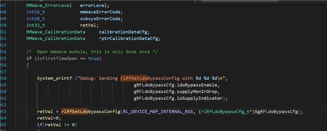

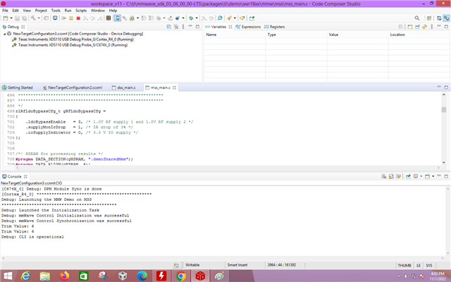

  • Hello Miao,
    No it is working alright, just try to check once without commenting the LDO bypass config in the mss_main().
    It should be working. We can close the thread after this check.
    Saswat Kumar

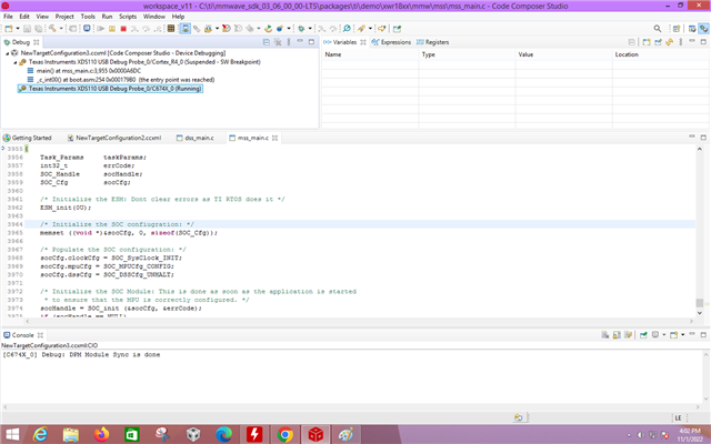

       Please kindly help to check the test progress from the customer:

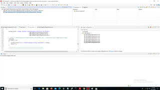

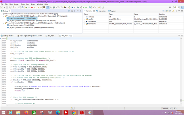

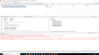

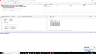

      "Flashed the device.
    Changed to functional mode by setting (s2s1s0=001), pressed NRST botton to power cycle.
    COnnected mmWave SDK.

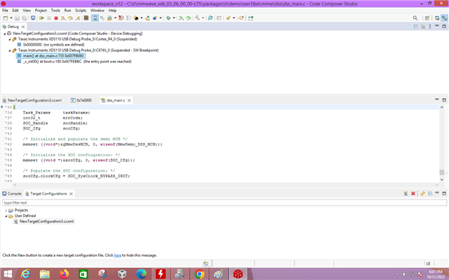

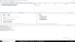

    Opened CCS12 and created target config file and launched it. (Fig.3)
    Connected C67x core and pressed reset in CCS. Connected R4F core and pressed reset in CCS. (Fig.3a)
    Loaded DSS into C67x core(Fig.4)
    Loaded MSS into R4F core(Fig.5)

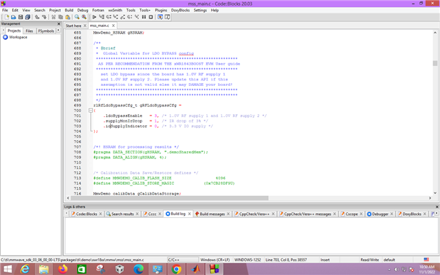

    Searched for LDO in mss_main(). Found a function from lines 699 to 704. Commented these lines. (I guess this is LDO bypass config you meant). (Fig.6)
    Ran C67x core(Fig.7)
    Ran R4F core
    mmWave SDK message appeared in mmWAVe SDK (Fig.9)
    Loaded profile_3d.cfg (Fig.10)
    Result appeared (Fig.11)
       Did I comment the correct lines for LDO bypass config? or are they some other lines?"

  • Hello Miao,
    I had mentioned to uncomment and revert the changes. Then rebuild the demo application and flash and try it.
    In this case the user has commented it again.
    Please do the same and let me know.
    Saswat Kumar

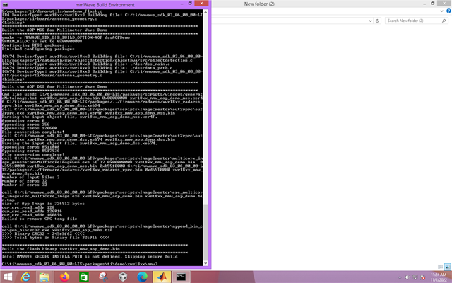

  • Hi Saswat,
        Good day!
        Here is what my customer have done,please kindly check :
    " Uncommented the LDO bypass COnfig (lines form 699 to 704) (Fig.1)
    Built the demo (Fig.5)
    Flashed the device (Fig.6)
    Changed the EVM to functional mode, Power Cycled the device. Connected to mmWave SDK (Fig.7)
    Opened CC, created configuration file. Lauched it. (Fig.9)
    Connected to C67x core, Reset it in CCS. Connected to R4F core. Reset it in CCS. (Fig.10)
    Loaded DSS into C67x, Loaded MSS into R4F (Fig. 12)
    Ran C67x core. (Fig.13)
    Ran R4F core(Fig.14)
    mmWave Demo message appeared in mmWave SDK (Fig.15)
    Loaded profile_3d.cfg from Plot tab. Output is appearing. (Fig.16)
    Have I done the correct steps, still anything needed?"

  • Hello Miao,
    When I mentioned uncommenting, I referred to the following lines which I had mentioned before to comment out:
    retVal = rlRfSetLdoBypassConfig(RL_DEVICE_MAP_INTERNAL_BSS, (rlRfLdoBypassCfg_t*)&gRFLdoBypassCfg);
    The above line is what I am referring to.
    Could you check if this is uncommented and working after rebuilding in case you need to make changes?
    As long as you are getting values in the plot after uncommenting it should be fine, you do not need to attach all the steps anymore.
    Saswat Kumar
  • Hi Saswat,
        My customer reply:"I have checked the line he mentioned was uncommented after rebuilding. Is It  ok right?"
        Thank you so much!
    Best Regards
    Miao Bai
  • Hi Miao,
    Yes, then it works fine. The issue is resolved so I am closing this thread.
    Saswat Kumar
