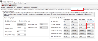

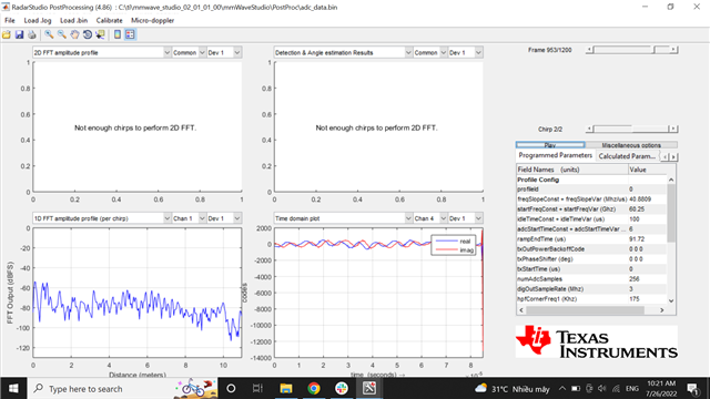

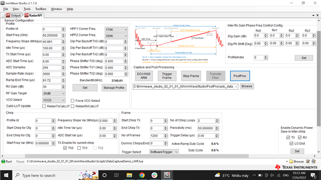

Hello everyone,
I'm currently working with DCA1000EVM and AWR6843ISK to collect data for vital signs detection task. Below are my configs and data after post processing. My question is whether or not the data is normal because it seem to me at the end of each chirp the value drop dramatically and what cause this behavior? Many thanks in advance
