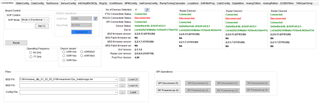

         Are you able to flash the devices following from user guide?
  • Yes ,I am able to flash BSS FW on all device all are showing SPI connected

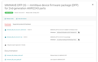

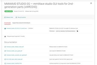

         Can you please confirm which device is mounted on your cascade EVM, also the revision of the board?
            Then you are flashing the wrong firmware and using the wrong mmwavestudio. Please switch to latest DFP and latest mmwavestudio.
  • I am using mmWave Studio 2.1.0 and mmwave_dfp_01_02_05_01
  • if this not correct ,please suggest the correct versions of both
          The kit is of Rev E hence it has AWR2243 on it and not AWR1243. So you need to use the MMWAVE studio and DFP for AWR2243.
    Studio:
    DFP:
  • Ok..I will try with this version. Thanks

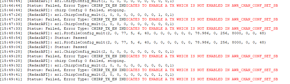

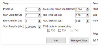

  • Now I have updated both. Still I am unable to set chirp trigger
    Do I need to configure all the APIs ? Or am I missing some steps?
                 Yes you need to set the Static configuration, Data path config and then the sensor config of all the devices.
    Only then you would be able to trigger the devices.
              Please send me your studio log file.
  • Getting this type error while doing
    set option

    [15:46:44] [RadarAPI]: ar1.ChirpConfig_mult(1, 0, 0, 0, 0, 0, 0, 0, 0, 0,1)
    [15:46:44] Status: Failed, Error Type: CHIRP_TX_EN INDICATES TO ENABLE A TX WHICH IS NOT ENABLED IN AWR_CHAN_CONF_SET_SB
    [15:46:44] [RadarAPI]: chirp Config 0 failed, stoping.
    [15:47:26] [RadarAPI]: ar1.ChirpConfig_mult(1, 0, 0, 0, 0, 0, 0, 0, 1, 0,1)
    [15:47:26] Status: Failed, Error Type: CHIRP_TX_EN INDICATES TO ENABLE A TX WHICH IS NOT ENABLED IN AWR_CHAN_CONF_SET_SB
    [15:47:33] [RadarAPI]: ar1.ChirpConfig_mult(1, 0, 0, 0, 0, 0, 0, 0, 0, 0,1)
    [15:47:33] Status: Failed, Error Type: CHIRP_TX_EN INDICATES TO ENABLE A TX WHICH IS NOT ENABLED IN AWR_CHAN_CONF_SET_SB
    [15:48:54] [RadarAPI]: ar1.ProfileConfig_mult(2, 0, 77, 5, 6, 40, 0, 0, 0, 0, 0, 0, 78.986, 0, 256, 8000, 0, 0, 48)
    [15:48:54] [RadarAPI]: Status: Passed
    [15:49:04] [RadarAPI]: ar1.ProfileConfig_mult(2, 0, 77, 5, 6, 40, 0, 0, 0, 0, 0, 0, 78.986, 0, 256, 8000, 0, 0, 48)
    [15:49:04] [RadarAPI]: Status: Passed
    [15:49:28] [RadarAPI]: ar1.ChirpConfig_mult(2, 0, 0, 0, 0, 0, 0, 0, 0, 0,1)
    [15:49:28] Status: Failed, Error Type: CHIRP_TX_EN INDICATES TO ENABLE A TX WHICH IS NOT ENABLED IN AWR_CHAN_CONF_SET_SB
    [15:49:28] [RadarAPI]: chirp Config 0 failed, stoping.
    [15:49:32] [RadarAPI]: ar1.ChirpConfig_mult(2, 0, 0, 0, 0, 0, 0, 0, 0, 0,1)
    [15:49:32] Status: Failed, Error Type: CHIRP_TX_EN INDICATES TO ENABLE A TX WHICH IS NOT ENABLED IN AWR_CHAN_CONF_SET_SB
    [15:49:41] [RadarAPI]: ar1.ChirpConfig_mult(2, 0, 0, 0, 0, 0, 0, 0, 1, 0,1)
    [15:49:41] Status: Failed, Error Type: CHIRP_TX_EN INDICATES TO ENABLE A TX WHICH IS NOT ENABLED IN AWR_CHAN_CONF_SET_SB

    [15:54:41] [RadarAPI]: ar1.ChirpConfig_mult(2, 0, 0, 0, 0, 0, 0, 0, 1, 0,1)
    [15:54:41] Status: Failed, Error Type: CHIRP_TX_EN INDICATES TO ENABLE A TX WHICH IS NOT ENABLED IN AWR_CHAN_CONF_SET_SB
    [15:54:58] [RadarAPI]: ar1.ChirpConfig_mult(2, 0, 0, 0, 0, 0, 0, 0, 0, 0,1)
    [15:54:58] Status: Failed, Error Type: CHIRP_TX_EN INDICATES TO ENABLE A TX WHICH IS NOT ENABLED IN AWR_CHAN_CONF_SET_SB
    [15:55:17] [RadarAPI]: ar1.ProfileConfig_mult(2, 0, 77, 5, 6, 40, 0, 0, 0, 0, 0, 0, 78.986, 0, 256, 8000, 0, 0, 48)
    [15:55:18] [RadarAPI]: Status: Passed
    [15:55:30] [RadarAPI]: ar1.ChirpConfig_mult(2, 0, 0, 0, 0, 0, 0, 0, 0, 0,1)
    [15:55:30] Status: Failed, Error Type: CHIRP_TX_EN INDICATES TO ENABLE A TX WHICH IS NOT ENABLED IN AWR_CHAN_CONF_SET_SB

                I see lot of critical failures in API issuance like chirp config and data path config. Can you please check what are you setting?
    I would recommend to first do a default configuration manually at your setup and then move to any scripts.
