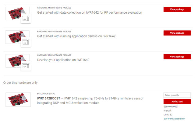

1.  There is a couple of packages in the IWR1642BOOST page, which package is most suited for the people counting demo?

    1. I suggest the getting started with running application demos bundle. This will let you test the prebuilt applications. If you want to modify and debug the source code, I suggest the develop your application bundle that includes the MMWAVEICBOOST board.

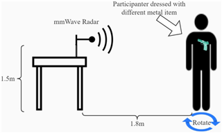

    Their company melt rebar to form different kinds of end products. There are a few cases where their employees are smuggling out the rebars daily to sell. I believe they are also planning to leverage on our mmWave technology to detect rebars rather than a traditional pass through metal detector. Is there any advise for such module?
    I believe it should be similar concept to the picture below, rather than gun, they are looking to detect rebars.

    The metal will be detected, but it will likely be similar detection strength to the human body as well. You may be able to see a difference in signal strength but it will be difficult. You will need to test to see if a different signature can be detected with your objects, as it also depends on the size and shape of the objects.
