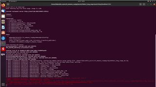

I am running a ros package, and I got this error
[ERROR] [1658958747.281385041]: mmWaveQuickConfig: Command failed (mmWave sensor did not respond with 'Done')
[ERROR] [1658958747.281412632]: mmWaveQuickConfig: Response: ''
[mmWaveQuickConfig-3] process has died [pid 89288, exit code 1, cmd /home/ilab/catkin_ws/devel/lib/ti_mmwave_rospkg/mmWaveQuickConfig /home/ilab/catkin_ws/src/ti_mmwave_rospkg/cfg/1843es1_long_range_3d.cfg __name:=mmWaveQuickConfig __log:=/home/ilab/.ros/log/66a06cc6-0df6-11ed-a40a-17a800feae50/mmWaveQuickConfig-3.log].
log file: /home/ilab/.ros/log/66a06cc6-0df6-11ed-a40a-17a800feae50/mmWaveQuickConfig-3*.log
    Can you first confirm that you are getting text output 'mmwDemo' from the applicaiton on the same COM port.? Application if flashed (in SOP5 mode) and bootup (in SOP4:functional mode) then application  ( mmw demo) prints out this text 'mmwDemo' which you should see on the PC end.
    Without this text we can't confirm if device is up healthy or COM port is accesible from PC to device to send command string.
