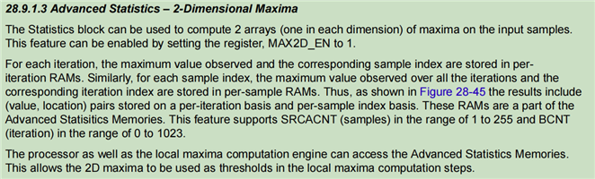

   The row- and column-thresholds can be selected from Maxima Arrays, I want to know how to obtain   Maxima Arrays.In the sector
28.9.1.3 Advanced Statistics – 2-Dimensional Maxima
 Acooeding to the above description, for evey input samples (2D arrays), we can botain 2D maxima array,in the description,‘
For each iteration, the maximum value observed and the corresponding sample index are stored in per
iteration RAMs’ ,in this statence,for each iteration means every 9 samples as belows, is that right?
That means the Maxima Arrays are  continuously changed and not constant ,is that right?

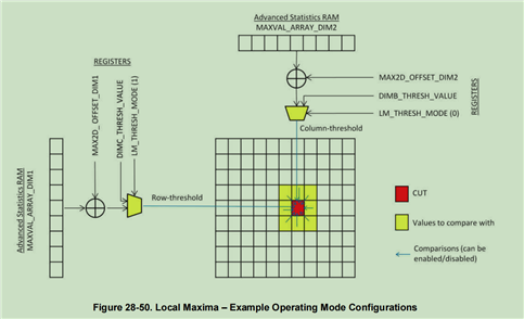

In the configuration,there are two setting  localMaxCfg.azimThreshold  and localMaxCfg.dopplerThreshold, from the picture below,can I understand like this?
the larger the  azimThreshold ,and the smaller the real Threshold and the more sample points are selected.

  • Yes,
    For each iteration the values are updated
    Could you please try to experiment with this feature?

  • Hi Rata,
                Why do you think the azimThreshold and dopplerThreshold values being set unreasonably will cause runtime exception? They are just thresholds right so more points would be detected by local max or less points would be detected by local max.
                 2D-max array computation in the high end corner lab demo is found at: C:\ti\mmwave_automotive_toolbox_3_6_0__all\mmwave_automotive_toolbox_3_6_0\labs\lab0015_high_end_corner_radar\src\datapath\dpc\dpu\dopplerprocDDMA\src while for the oob demo, 2D-max array computation is found at: C:\ti\mmwave_mcuplus_sdk_04_02_00_02\mmwave_mcuplus_sdk_04_02_00_02\ti\datapath\dpc\dpu\dopplerprocDDMA\src\dopplerprochwaDDMA.c.
