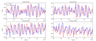

    And UDP packet data is 16 bits (range: -2^15~2^15). How can I process UDP packet data ?? Because the data of "C:\ti\mmwave_studio_01_00_00_00\mmWaveStudio\PostProc\adc_data_Raw_0.bin" and UDP data is not same.
    When I process data of "C:\ti\mmwave_studio_01_00_00_00\mmWaveStudio\PostProc\adc_data_Raw_0.bin", the results is correct:

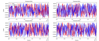

    but when I process data of UDP packet data from DCA1000EVM through an Ethernet port the data is not correct, it is so noisy:

    There is some re-ordering performed on the UDP data as far as I remember. Some frames are out of order.
    So, you will not get correct data by reading the UDP data.

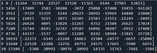

    I print the tenth first UDP packet data received from DCA1000EVM through the Ethernet port. The first column is the Sequence number, the second column is the Byte count, and the third column is an array of Raw mode data (1456 bytes-after convert is 728 values and I show 8 values first). In AWR1243BOOST, I configure the frame: Periodicity-200ms, No of Chirp Loops-1. In the first frame, I have:
    ADC samples(256) × num RX (4) × IQ(2) × Chirp Loop (1) = 2048 Values
    - So, I process 4096 bytes (2048 Values) in C:\ti\mmwave_studio_01_00_00_00\mmWaveStudio\PostProc\adc_data_0.bin", the data is correct.
    But,
    When I read UDP packet data, I used 728 in the first packet, 728 in the second packet, and 592 in the third packet then the results are not correct.
    Is this correct for my pick from UDP packet data?
