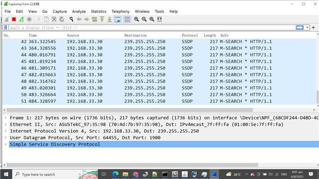

       I have tried again and the DCA1000 Ethernet stopped working again. I run the program at 3:00Am and check the program at 8:30Am, and the mmWave Studio and our program are running but the Ethernet stopped working. I use Wireshark to check the Ethernet and find that it stopped working.  I also cannot ping the DCA1000.

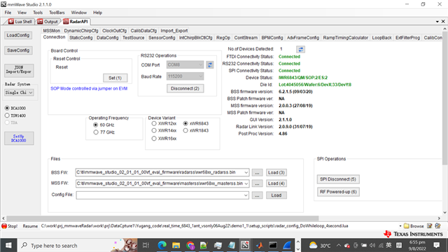

  • Hi Abhed,

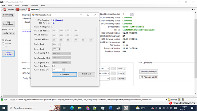

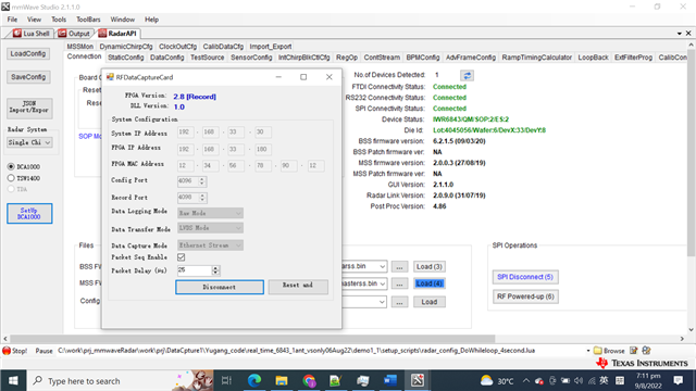

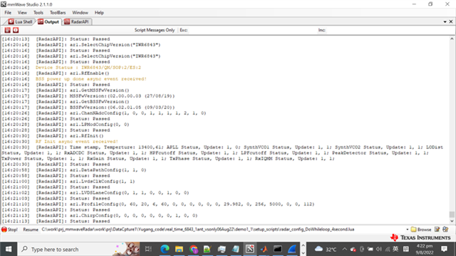

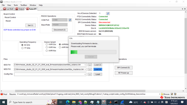

         Today I have tried again. I started the  mmWave studio + DCA1000 with our program at 11 am and found that the Ethernet stopped at about 16:00 pm. And I checked the mmWave Studio is working fine. I can set and download both the BSS FW and MSS FW files. And I can also set the Radar parameters. But I can not reset the Ethernet.  Please check the pics:
     Can you please confirm the firmware version of DCA1000 from the connection window(RFdatacapturecard window) and share the snapshot of it?
    regards

    The FPGA version is 2.8.
    The Rfdatacapture window:
    And:
    Regard
                    The FPGA version still reads as 2.8. Please confirm if you updated the image on the DCA1000 with the 2.9version.

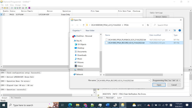

  • Hi Abhed,
        I have re-do the FPGA 2.9 version image update. And I restart the mmwave studio, and check the RfdatacaptureCard. The version is still showing the 2.8.
      I followed the Document of image update and chose the file: DCA1000_FPGA_RECORD_V2.9_21JUL2022.bit. And the DCA1000 board program SW is correct. The update of new image is successful.
    INFO - Check configuration setup: Successful.
    INFO - Device1 LFE5UM-85F: Erase Only
    INFO - Operation Done. No errors.
    INFO - Elapsed time: 00 min : 00 sec
    INFO - Operation: successful.
    INFO - Check configuration setup: Start.
    INFO - JTAG Chain Verification. No Errors.
    INFO - Device1 LFE5UM-85F: Erase,Program,Verify
    INFO - Elapsed time: 02 min : 41 sec
    The image update is successful. Why the mmWave studio is still showing the 2.8 FPGA ?
    I also tried to press the push-buttons on the DCA1000 board. And the status is the same. Can you share us the new 2.9 version FPGA image again?
  • Hi Abhed,
       Now I successfully update the image and the FPGA version is 2.9 Now.
