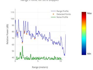

I have some questions about CFAR detection of IWR6843AOP.
1.
When I used the configuration1.cfg (range CFAR is CFAR-CASO), AOP EVM works well. But incase the configuration2.cfg (range CFAR is CFAR-CA, parameters are same as doppler direction),
the detection result is strange. Not peak range bin is detected but "valley range bins". Is configuration2.cfg not correct? (the picture below is example.)
2.
As written above, when I use configuration1.cfg, it works well but looking at the SNR value in detected object side info, the minimum value is about 11 in spite of CFAR threshold value is 15 in configuration2.cfg.
I think SNR in detected object side info is SNR of range CFAR. Why minimum value of the SNR is not equal to CFAR threshold?

  • Hi Nathan,
    Regarding question 1, in case configuration2.cfg, please see the picture below.
    It is the snapshot of range profile when I use configuration2.cfg.
    Because guard length is 2, and noiseWin is 4, average of noise is higher than CUT obviously.
    I can't understand why the CUT is detected.
    What kind of things do you think could be the reason?

  • Hi Kei,
    This does seem like problematic behavior. Are you using the most up-to-date code? Which binary and which visualizer are you using?

    Regarding question1, I am using IWR6843AOPEVM, xwr64xxAOP_mmw_demo.bin(SDK3.5, pre-built binary), demoVisualizer 3.6.
    By the way, does 6843AOP + 64xx binary support CFAR-CA?
