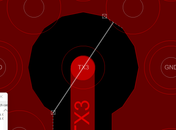

Hi all
When i see the demo board of AWR1843(REVD), i find that the RF line route avoidance is nearly 15mil, the demo board use 4mil height Rogers4835
I use Rogers3003 in my board , but i want to check with you how many space need i use?   15mil or smaller?
