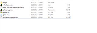

We found that if we flash board with binary file in ti\mmwave_industrial_toolbox_4_1_0\labs\people_counting\16xx_people_counting\quickstart it works fine.

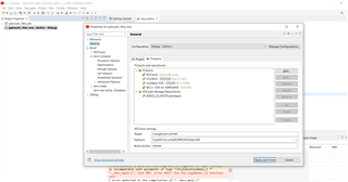

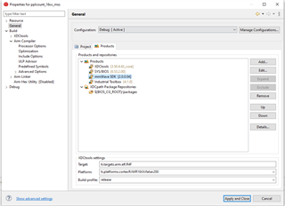

But if we import the project from resource explorer than build and get a binary than flash the board with this binary it does not work.
Board gets the configs and answers.But data messages is looks like device not found any points.
in the MmwDemo_mboxReadTask code enters MMWDEMO_DSS2MSS_DETOBJ_READY but points is always 0.

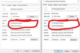

İt is clear that there is a difference between resorce explorer code bin file and quickstart bin file.
