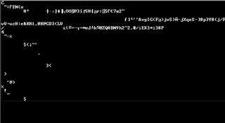

  • Alec,
    I connected to Tera Term and now all I see is this:
    I connected to the XDS110 Class Application/User UART. Before connecting to Tera Term, I confirmed that the GUI was receiving output, and then I disconnected the Gui and closed UniFlash. My device is in functional mode. This results from toggling the NRST button or from running from the debugger. I have my Tera Term speed set to 115200, which is the recommend speed listed on the GUI. Can you advise as to why no data is populating?
    Edit: I also have it set in functional mode, 1 0 0.
    Edit #2: I have also attempted this across the XDS110 Class Auxiliary Data Port at the recommended baud rate of 921600, and I get this:
    Yes, the info you are seeing on the XDS110 Class Auxiliary Data Port is the actual radar data. Since it is in a binary format, you will likely want to use the logging function built into teraterm (make sure to select the option to record as binary format) and then you can refer to the lab documentation for more info on the exact format of the binary data. If you want to make a custom data format, you would modify the UART data transmit code in the lab in order to do this.

  • Hm. When I set the option to record in binary format, I still get gibberish. I looked into the lab documentation prior, so I know that I should be seeing some combination of headers, "Magic words", and data. Is that expected, and I should move on to Tera Term forums/documentation, or should I be seeing readable data?
    When you say gibberish, what exactly do you mean? When you record it as a binary file, you should be able to view it and scan for the magic word, and then follow the frame format to parse it. Feel free to attach a sample log here if it still does not make sense. Also, be sure that the data port baud rate is set to 921600, while the CLI baud rate is 115200.
    Alec
  • Using Tera Term, I was unable to get it to show in a binary or hex format in the terminal. However, I've since switched to Serial Port Monitor and was able to get that program's file to open in hex. Interestingly enough, I don't see the magic word. According to main.c, I should be looking for:

    I believe this can get a bit weird due to byte ordering and endianness. I pulled up a log I had laying around for a different demo, and I believe it appeared as
    02 01 04 03 06 05 08 07. The easiest thing would likely be to record a log of the UART stream, and you should be able to pretty quickly identify the magic word. However, I believe the pattern that I posted above should be correct.
