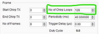

I am using wave Studio, I have a question:
- In frame config, what is No of Chirp Loops mean?
Tuan Trinh The
  • Hi Tuan,
    "No of Chirp Loops" refers to the amount of times the configured chirp is going to be transmitted within an individual frame. In your screenshot, you've got Chirp 0 selected as both the start and end chirp. This specific chirp will be repeated 128 times within one frame. The frame will then repeat every 40ms, once again transmitting Chirp 0 128 times. This process will repeat 8 times as the "No of Frames" field is set to 8.
