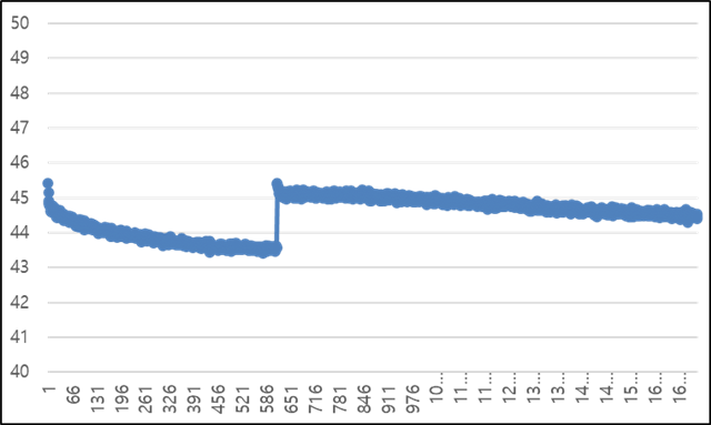

I measured SNR of 10dBsm corner reflector at 15m apart using AWR2243 cascaded radar.
Firstly, mmWaveLink_Cascade software was built, and measured SNR for 500 seconds.
As the temperature goes up to 100 ℃  for 500 sec, the measured SNR goes down approximately 3 dB.
I tried this test several times.
Most of the times the results are similar, but one case is different.
The SNR degradation is small, approximately 1 dB.
In 2nd figure, stop and restart of radar was done in discontinuity point.
In all test cases, the test was started at 40 ℃  and stops at 100 .
The temperature was read from AWR2243.
I am using DFP 2.2.2.1.
I checked radar config. APIs(rlSensor.c) which affects this difference.
But I am not sure what API affects the SNR difference?

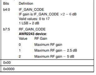

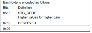

  • Hi Misra,
    In ICD, RX gain code is
    this document says max RX gain is 17.
    And TX gain is as follows,
    Then max TX gain is 63.
    But I read the following LUT from the AWR2243.
      <-30 <-20 <-10 <0 <10 <20 <30 <40 <50 <60 <70 <80 <90 <100 <110 <120 <130 <140 >140
    RX 75 75 75 76 76 76 76 77 77 77 77 77 78 78 78 78 79 46 46
    TX 41 42 43 44 46 47 48 50 51 49 55 57 60 62 65 67 70 72 75
    The gain table is different from those of ICD.
